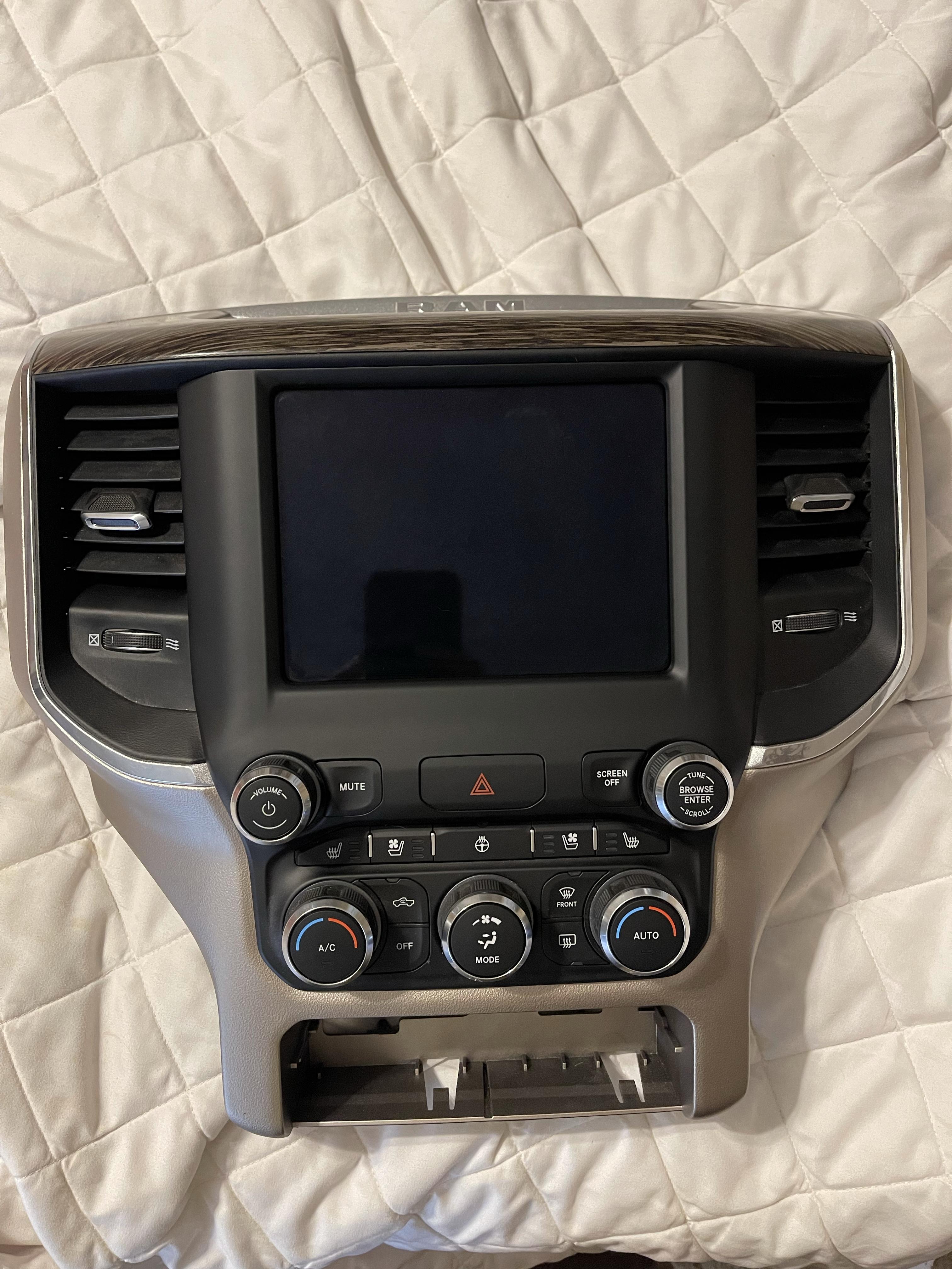

I have the 6.7L and trying to verify the center stack:
68370127AA - center stack​
Jackmup
Joined
Dec 13, 2020
60
59
That stack looks like it has heated steering wheel and seats. It's for the diesel but what trim level and options do you have? It's worth taking a ride to a dealer and locate a truck with the exact one you want, write its vin number down and go straight into the parts dept. They can pull it up by vin. The lower aux and Jake buttons dont come with it. They get transfered over to the new center stack.

Upgraded it. Just need a new ac bezel now. The original one doesn’t sit right. Not only does the 2 plastic tabs don’t line up, the upper 4 screw holes don’t either and the screen doesn’t sit 100% right plus there is a gap at the top of the center stack. Now my problem is my active lines won’t turn on and stay on. I push the check mark , it shows it’s checked off and then 2 seconds later it goes away. Anyone have this issue? Maybe it needs to learn and adapt to the truck? Also I can’t push the little magnify symbol to change the camera view when backing up?

68428584AC radio has the apple car play correct ? Im running one from a 2019 1500 but my active back up camera guide lines won’t stay checked and my blue tooth buttons don’t work on my steering wheel so I’m going to have to sell this one and get the correct one.

It depends on what engine you have. If you have the 6.4 you will need the center stack with the single center button for the 4 ways only. The Cummins gets the split button because both engine options use the same position in the lower switch bank for the traction control and exhaust brake. So, if you have the diesel it will push the traction control button up into the split controls along with the 4 way flasher button.
There are what it seems like a thousand different part numbers for the same part because all trims levels use them, all being different. So, it all depends on what you want to install.
I have the 6.4. These are the part numbers that I used. They are for the Tradesman trim level.
68428584AC-Radio-Multi Media
68340283AD-Center stack control
6VQ511AHAA-Bezel-instrument panel
68354583AA-8.4 Radio bracket
You can refer to page 66 entry #1319 in the 'What did you do to your ram today " thread to see what I did.
A signature line with what you have or are going to have would make it easier to help you.
Just installed the 8.4 into my '19 Tradesman using the above listed parts from b307a1. The radio was on a long back order. Ordered in Aug, arrived last week. Loving the Apple carplay! Anywho, all installed and seems to be working good except for the backup camera. The clarity is awesome, but it seems the aspect ratio does not fill the whole screen. I also lost the feature of switching the view to look straight down at the hitch. Anyone else have this issue? How to correct it?
Also lost the VR and phone button on the steering wheel. Anyone else have this issue?
Forgot to add, the compass also does not show under apps.
Disregard! Just went outside to check something and all works as it should. I guess the radio needs to l"learn"?
