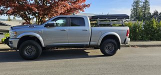

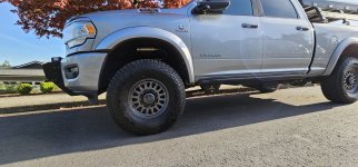

Also installed Thuren V2 Boogie Bumps, more pictures in Suspension page post.View attachment 72154View attachment 72155
Very nice! what is your lift in the front? Looks like about an inch between the bump stop and axle? I am planning to install thuren 2" coils in the front and am thinking about these bumpstops too. Did you do the rears as well? From my offroading experience with the 2500 CTD, the front would benefit the most from these bump stops... thanks

I have the the Thuren .5” coils for my 3500 and netted 1” of lift based off center of wheel hub to fender measurement. With the softer coils I can still bottom out the front on hard hits so these soften it up a lot. I don’t have rears yet but I have leafs with the carli add a pack so different setup. But once Thuren releases their new Load Control Boogie bumps for the rear I will be getting them. They already have them for the 2500’s and look awesome.

I like your decision making ha but ya install is pretty simple, as instructions state that bump stop mounts vary between trucks and there may be some weld slag or imperfections that need little filing to get the bumps to slide on all the way. I didn’t need to file anything, just some taps with a hammer got them in place good.

I thought the same, they are pricey. But I am pretty sure its stainless so that made me think the price is justified.
