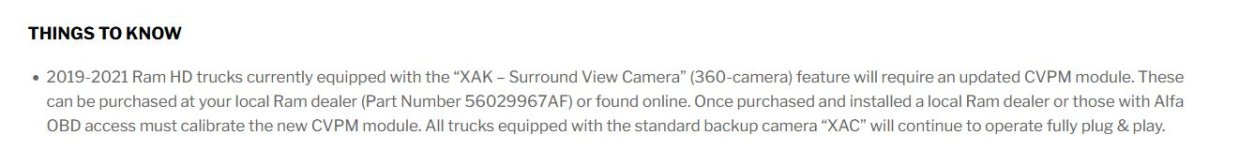

I just installed my UConnect 5 in my 2020. Everything works except the cameras. I still need to upgrade the CVPM Module. I bought the Uconnect from Infotainment and on their website it gives this part number for the Module (Part No.: 56029967AF). Anyone else use this part number CVPM?

DO NOT buy that module for a HD Ram. That is for 2023-24. Buy this one - 56029965ac (and maybe that one from Info would work, but this one is what I used, and I know for sure it DOES work).

Just found this on their website.
Yep, that's the part number for the 23-24 Rams. I ordered one for the 22. Can't remember why.. but that's what I did.
