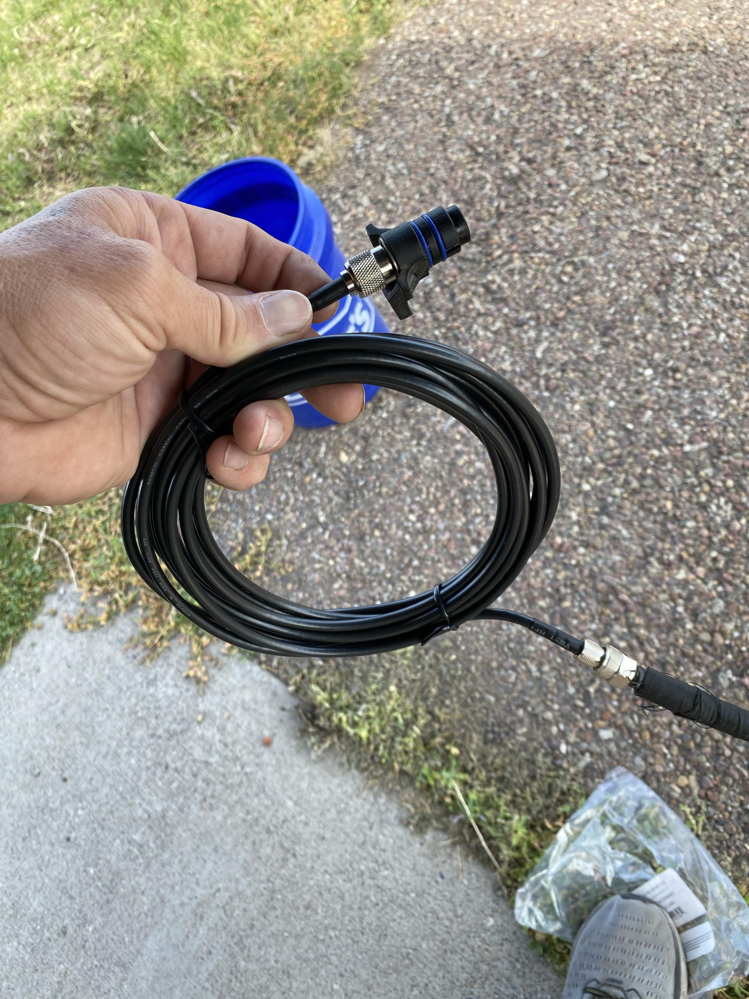

I just installed the the RG58 cable 25’ to replace the RG174 20’ on the camera end and it works yea. I’m not sure why the 174 worked when coiled up on the tailgate but once I ran it through the camper it wouldn’t even bought another 174 thinking I damaged the other one still wouldn’t work. I guess what I’m saying the 58 with the thicker size wire can still carry the signal through it even with an extra 5 feet that I didn’t need.
Good to know. I’m here in Yellowstone now, so once I get to some form of civilization I’ll get an RG58 on order. I’m liking the suggestion [mention]Jimmy07 [/mention] has about putting the extension on the vehicle side with the 15’, and that’s all I may need.

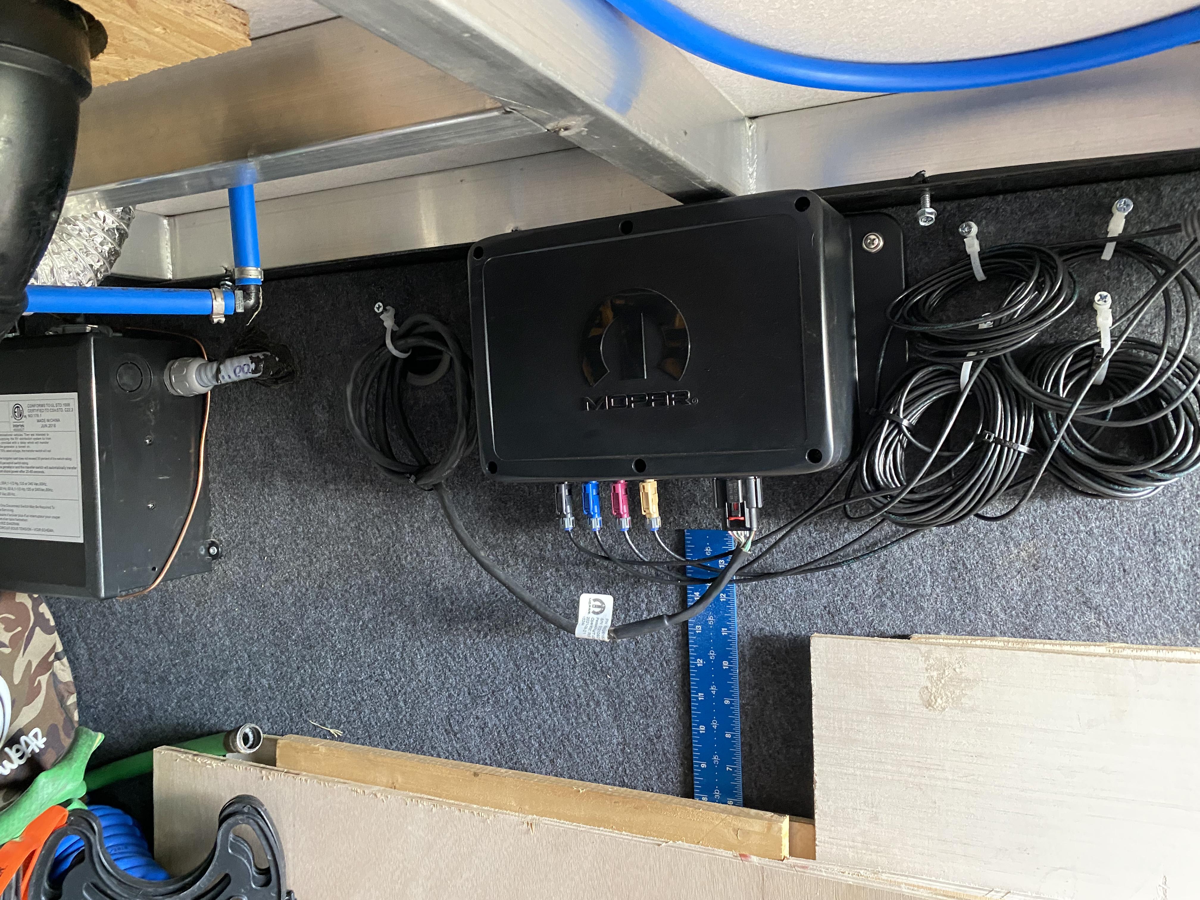

I just hooked up the 20 foot fakra extension cable along with the 50 foot cable that it comes with camera kit and the picture is still crystal clear in the mirror. Both ends of the extension cable both clip in and lock in.
So I guess there’s hope for us people with big 40- 45 foot campers.

[mention]22limited [/mention] and I, probably a few others, have used extensions for our 5ers. The problem is, as [mention]Jimmy07 [/mention] has graciously provided a solution for, we used RG174 cables. The 174 from Bingfu has the fakra connection and works fine in cool, damp conditions but is too thin to carry the signal over long distances for our applications. I’m currently running 16’ of 174 and found it works great if it’s raining, but not when it warms up (flickers in/out then drops).
Look above for the link that Jimmy provided me for the RG58 cable (TNC connection). It ties into the vehicle side (the connection to the vehicle screws off, the extension is added, connector on extension). I ordered mine as soon as I arrived at Great Falls, probably going to have to extend here a day for delivery and installation.

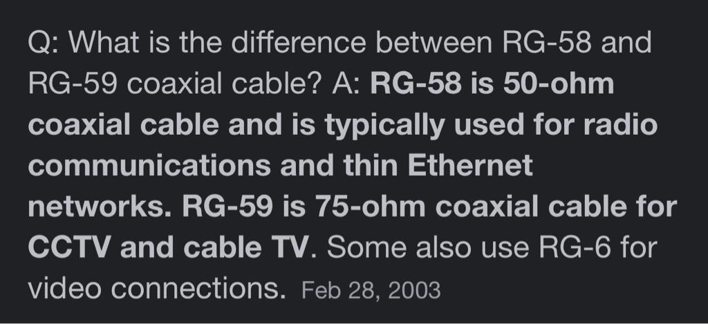

I’m not an expert at this kind of thing, did a bit of research on the Radio Guide (RG) rating system. They’re pretty random, but the one we’re real familiar with is the RG6 used for sat/cable tv. RG58 is inferior to 6, and RG59 seems to be more for CCTV applications which has me wondering…but, 22 said he’s upgraded his extension to a 58 and everything works fine.

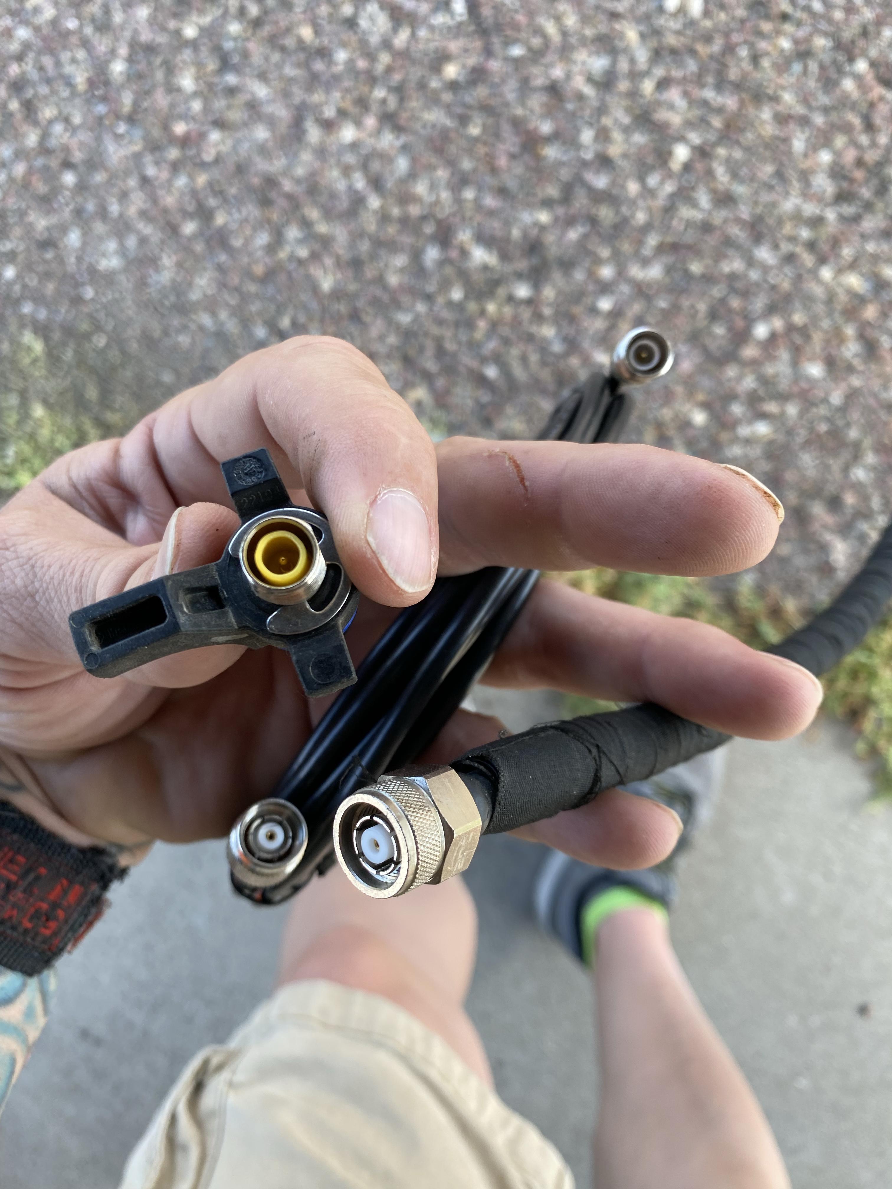

It would probably be easy to CAD and 3D print that connector with some good measurements if you can source the insert. I didn't realize it wasn't molded in.
I’m just not sure what connection it is. The camera end of the cable is Fakra, the truck end is TNC(?). The bumper connection is TNC(?) to some form of slip on that isn’t either.

That’s a no-go! Playing fits with the system, wouldn’t even register the camera attached! [mention]22limited [/mention] which RG58 worked for you?

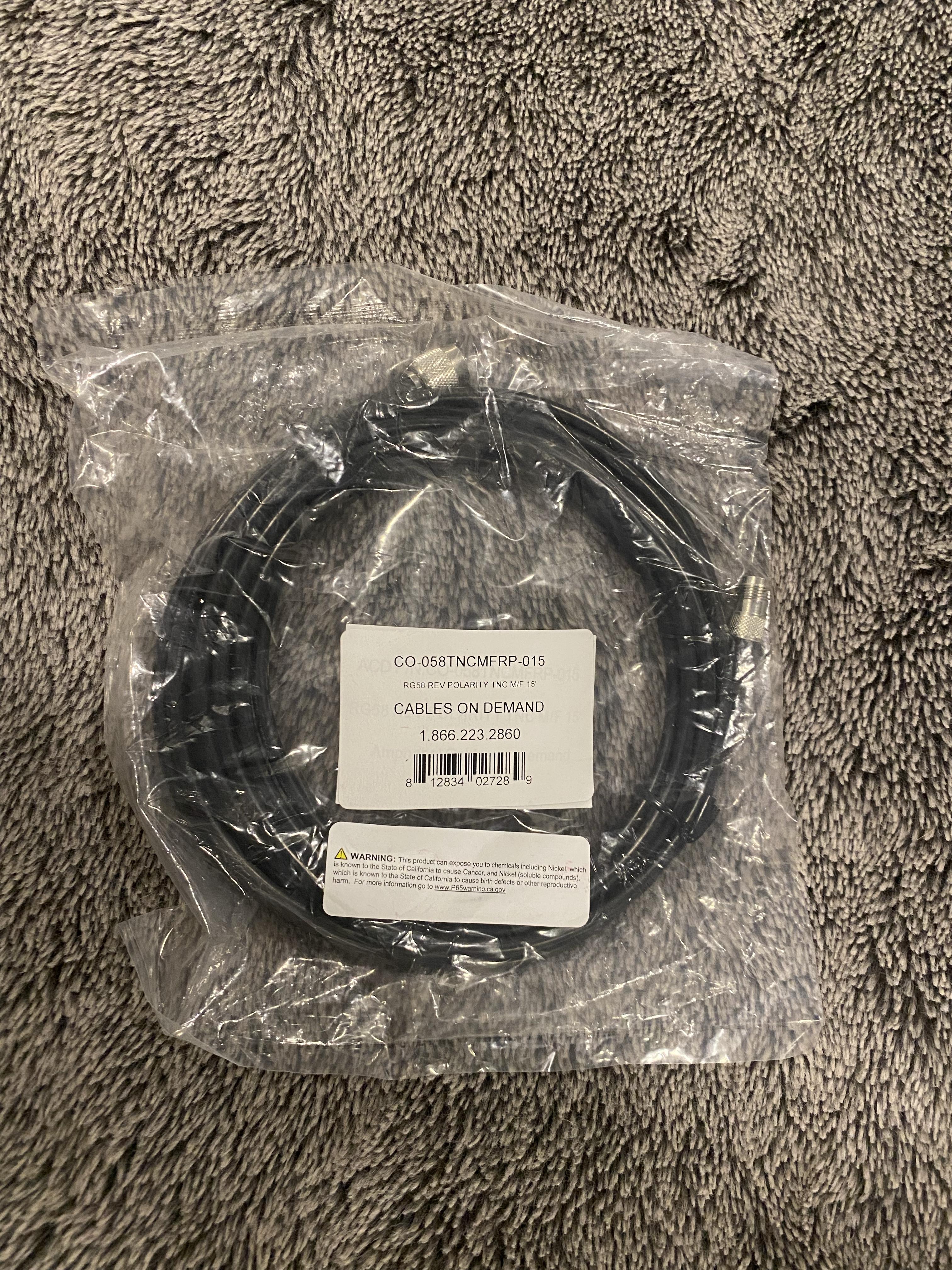

YES! Thanks to [mention]Jimmy07 [/mention] and [mention]22limited [/mention] I have finally got a cable installed that works…for now. I have yet to hit the road for an “underway” test, but unpackaging and hooking up for a static test, things worked fine.
If anyone is looking at running an extension for their trailer digital rearview mirror, I have found you need to use a RG58 cable with FAKRA Z connectors.
My first attempt to run an extension was a 20’ extension from BINGFU on Amazon. Just sitting static, the picture signal was intermittent. I shifted to 2 x 6’ BINGFU extensions, and that worked fine static…for a bit. I found on the road that when it heats up the signal would become intermittent again, and eventually drop.
Jimmy07 explained that it is an impedance issue, the BINGFU cables are a smaller RG174 wire, and I’d need to upgrade to a thicker RG58. He suggested trying a 15’ RG58 cable with TNC connectors that could be attached to the truck side of the factory cable. The TNC (threaded) connections are a great idea, a snug and reassuring fit, but I found that the truck didn’t recognize the trailer camera connected at all. There is something about the connection on the truck end, YOU CANNOT SIMPLY RUN AN AMAZON EXTENSION ON THE TRUCK SIDE.
I asked 22limited what he had ran, to achieve success. He told me he used a 25’ cable from Amazon that I quickly found (there’s only one with Fakra Z connections) and forwarded to him for verification. Once I got the thumbs up, I placed the order. It took awhile to receive it (on the road) but I did the install yesterday and sitting static, no issues.

YES! Sorry, I have been so busy I forgot to post results. I installed near Moses Lake, WA and have made three trips since.
The first: Moses Lake to Whidbey Island, I found that when I plugged into the RG58 setup there was no change to my truck’s rear view mirror (not that I could tell immediately that is). I went in and manually selected the trailer view and there it was. I don’t recall any issues along the route.
Second: Whidbey to Chehalis, WA. I believe I had to do the same, manually select trailer cameras, but no hiccups. It was amazing to transit through Seattle/Tacoma seeing what was going on behind me (same as up to Whidbey). Helped get through the two hour traffic jam that I-5 has become.
Third: Chehalis to Neskowin, OR. Once again, manual select of the trailer view, but on this trip I recalled ONE hiccup. The screen went black for a second, but trailer view returned instantly.
My adventures with the RG174 cable has been this… Cool mornings, the truck sees the trailer camera, but as things get warmed up I started seeing these hiccups (signal outage) eventually I would start seeing “Digital Rearview Mirror unavailable” and all I would see is a black screen with a flip-down icon. Eventually this would give way to the truck camera taking, over showing the nose of my 5er. Now, sometimes I was able to go in a press some buttons and get it back, but eventually it was a lost cause. The ONLY times it had sustained operation was during rain (cool, damp conditions increase impedance).
Since switching to the RG58 cables I found this out… the TNC connection (truck side of MOPAR’s cable) did NOT accept an extension. I’m not sure why, but the computer driving the rear view system did not like the signal it was getting. It would try, as if it recognized there was something attached, but I wouldn’t get the glimpse of a picture from the trailer at all. Bring us to the FAKRA Z end… the cable I have (shown above) works almost perfectly. As stated, I have been manually selecting the feed, but other than the one hiccup I can remember, the setup is sound. This could be due to the 25’ extension. All I needed was 15’, but the lengths available on Amazon were 6’, 10’, and 25’. I wanted to use as few connections as possible, if 25’ worked good, if not I’d try 10’ and 6’. So far, over 700 miles, it’s held up to what I would call acceptable.
