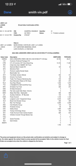

So, I’m trying to make my way through this thread, but long story short…BLUF…I’m trying to figure out whether I need to by all three Furrion cameras.
I have the trailer surround view and the wired rear camera package on this build, I know the 40’ rear camera won’t reach the back of my 44’ 5e. So I’ll be looking at purchasing Furrion system, just not sure if I want to go with a single rear or that and the 2 side mounted turn signal cameras.
Now, I currently drive an ‘06 so all this new tech escapes me. I could be way off, but I think the idea is for situational awareness while driving. If I’m way off than I’d have to get the complete Furrion system for my intentions.
I’m just trying to find more info on this set up.

I dont know that Furion will work either. My experience 3 years ago was the Furion at that time was challenged at rear of 30 ft of enclosed trailer - may work OK for cameras mounted on side toward middle of 44 ft trailer or maybe technology / range has improved, but I would do a bit more research on Furion rather than here. Maybe talk to Furion dealer and get some kind of guarantee they will work for that range or return for refund?
And 3 yrs ago, we had to splice camera power to tail light wiring and that was not very satisfactory - and lights had to be on to power camera. Tail lights always seemed dim but in fairness camera was installed at purchase of RV so we never had a before and after comparison.
Since you already have Trailer Surround pkg, you might want to try it before jumping to Furion. I dont have specific knowlede of the MOPAR Trailer Surround, but I believe it is 4 cameras - maybe put 2 on either side as far as wire will reach pointing back and other 2 midways pointing down/out?
As for Tow View system, I believe you are correct about its range limit, but again if you already have it, buy a 10 ft extension and try it.
Best, Ed
Best, Ed
