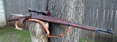

Lost it just below the Spring Mountains in 1985, it laid until 1990 whereupon in went into the evidence vault, they sent a letter 33 years later. It was poop.
Received a rear sight and grip for it yesterday, back in business 38 years later.483B4DE8-7830-45FC-88B0-665DDCABAA99.jpegB4388640-B132-4AFE-9264-E65C7375CBA9.jpeg
