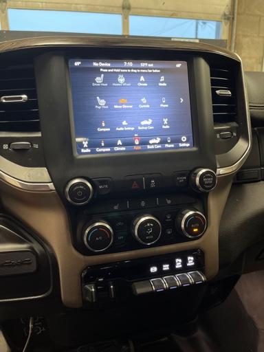

Post a pic of your current 8.4 bezel, and I’ll see if I can find the one that matches yours with lane assist.Wonderful, I appreciate it. I wasn’t able to find a vin with the 8.4, but you had mentioned it in an old post and I was just curious.
