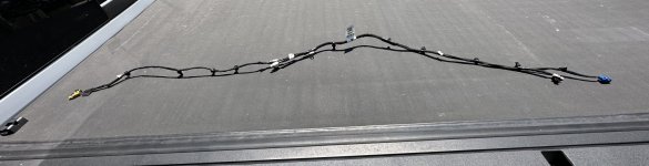

I have a Tradesman standard cab no roof lights and I did have a harness already there. It was for the two antennas on the roof. Really easy to replace with the new harness though, if anything it helped having one to follow and use the same clip holes. Took about an hour to swap out, no issues at all. Pull the weather stripping, remove the grab handles (2x10mm bolts) and A pillars (pull once unbolted), then pop the side panel open. Trace the old harness removing the visors (2x8mm bolts and 1xT20 torx) then remove the overhead console (2x8mm bolts and clips). One remaining 8mm bolt and the passenger side headliner drops down with plenty of room at the windshield. Do same for the drivers side as m the harness goes to an antenna over there too.
I don’t have my DASM or new windshield installed yet, so i just left the extra clips tucked in headliner over the sunglasses holder for future install completion.
Panel removed showing where new connector plugs in and the two other connectors (blue and white) behind a pillar. Old harness also shown for reference.

Harness, buttons and new mirror installed. Waiting for the DASM to arrive (expected today!) and then will schedule windshield. Replacing the harness wasn't awesome but not terrible either.
