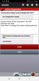

An update for me with installing Aux switches ..I own a 2500 2019 RAM Laramie. In the process of installing the Aux Switches. I have the switches installed and power (I believe) to the switches. By turning on the settings using AlfaOBD shown in my attached pics (first is the "Customer.Set.Menu 1 - Auxiliary Switches CSM" option selected was "Switch 3-6 option") I had the commercial menu become available on the instrument cluster (allows control of permanent power or ignition power etc for all six switches even though the option only says 3-6).
The second pic shows the setting that tells the BCM you have the switches plugged in and then allows them to be turned on and off (with the respective indicator light coming on on the front of the panel). What I can't find though is the output for the Aux switches. I've measured each of the wires and empty terminals on the back of the plug and don't get any change from the readings regardless of the switches being on or off.

How are you trying to measure the wires that come from the switches? Those aren’t the actual power output wires. All those wires do is complete ground to energize the relay coil in the aux fuse box. So, let’s say all you have installed is the switch bank and the 1-6 switch wires, and you want to see if the number 1 aux switch wire works- you would set your meter to ohms (or continuity buzzer), activate switch 1, probe switch 1’s wire, and put the other probe to metal ground, and you should have continuity.
Ah, silly me!! Of course they are negative switched. just went and checked and yes they are connected at the switch. Thank you Jimmy07 for your guidance and the images they will help immensely in finding the wires underneath the dash! Which will ultimately save me time and energy.
