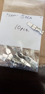

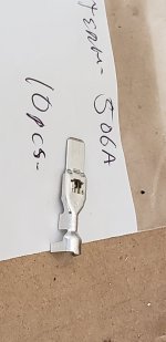

I found the terminals that I needed for the fuses in the Aux PDC I bought them from Connector Experts (they weren't cheap for the 10 of them but that's all that I needed). Terminal number 506A fits perfectly.

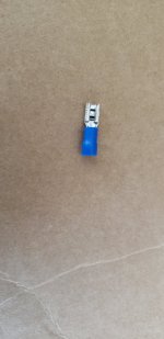

as for the other terminals in the Aux PDC, I was able to modify a standard yellow female connector to correctly locate into the slot.. took some time to modify and I even took a little video if anyone is interested... I'll have to figure out how to share that as it's a massive file size. basically what I did was lever up the middle section at the back enough to allow my diagonal cutters to cut the middle section, once that was cut through I bent up each side and trimmed to the correct length and then bent them back down. This modified female connector can be used in the input and output of the relay (from fuse and going to the item to be powered) total of 12 to wire all 6 relays.

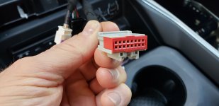

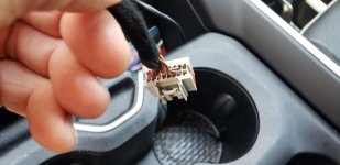

and finally for the control side of the relays (input and output) I used one of the terminal 506A connector to pull power from the Aux PDC power busbar (just like for the relays), I was able to get all my control wires off of the one connector, but would recommend wiring up 3 per connector to make it easier. These connectors/terminals also standard and didn't need any modifying to locate into the Aux PDC. I did however remove the blue shielding to make it easier. all the terminals/connectors fit properly into the Aux PDC box and are fully protected within each slot. The output of the wires is what I then ran through the firewall (used the clutch cover with a grommet and silastic to fully seal) and hard wired them to the wires at the back of the switch.
