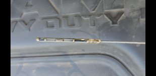

Maybe, maybe not. My truck was regening every 20-25 miles. No CEL, bore scope of DPF when it registered 48% full (going into a regen). A manual cleaning showed 4.2 grams of soot with 42 grams being the regen point. And I have about a gallon of diesel in my oil - which will be confirmed as soon as I get the truck back from the dealer, change the oil, and send in the Fleetguard UOA. Because unfortunately I was told they don't do oil changes even if the dilution is caused by a failed part. With that said, they replaced the MAF yesterday, and are doing the computer relearn today followed by a full on test drive to see if the DPF registers full again too early. I'll definitely keep everyone on here posted as I learn more, but I've attached my dipatick photo from just before taking it to the dealer
I could see my issue being pressure differential sensors, bad injectors and or pump, or the MAF. However, the amount of oil I'm "making" leads me to think injectors or pump or both. I have a hard time thinking in less then 2800 miles on my oil change that I'd have that much diesel in my oil just due to the regen process
