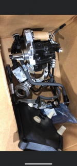

[MOD: CP3.3 retrofit kit]
index.php
New pump tag:
Base Y78 Recall pump kit:

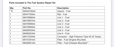

Full failure mode additional parts:
