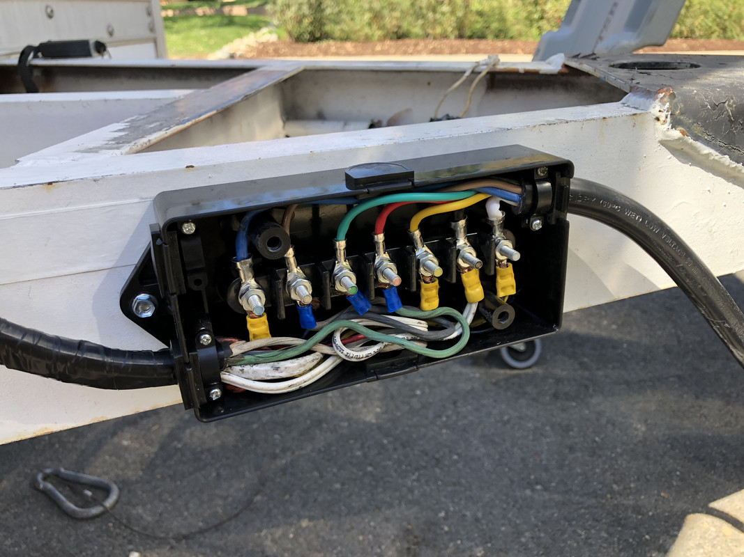

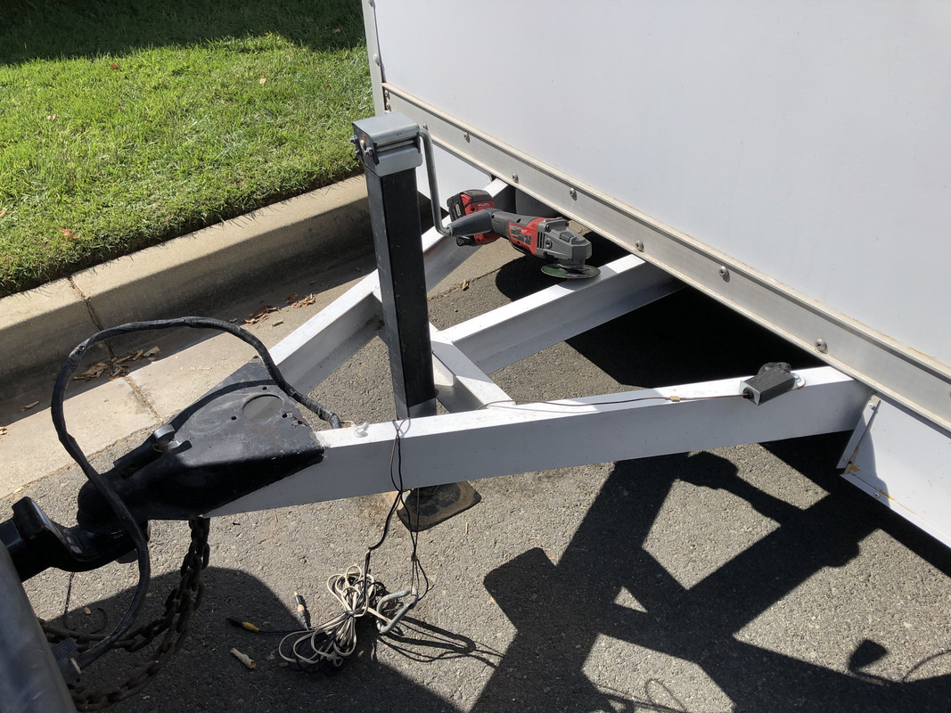

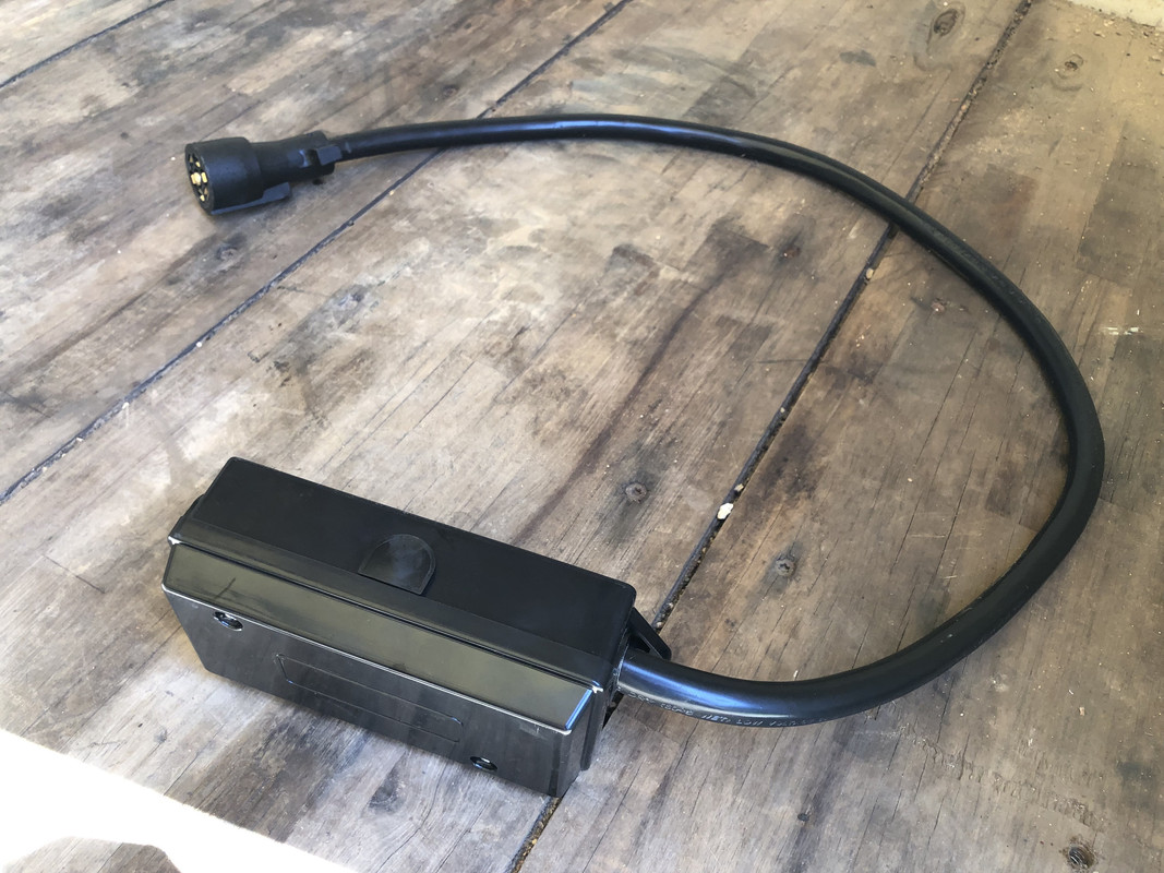

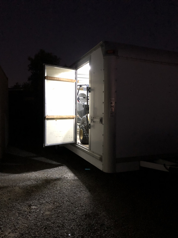

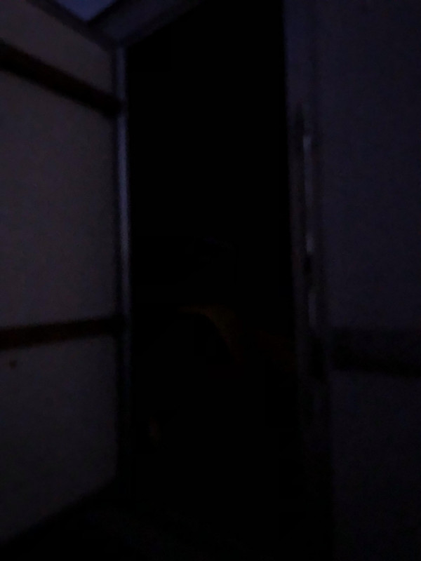

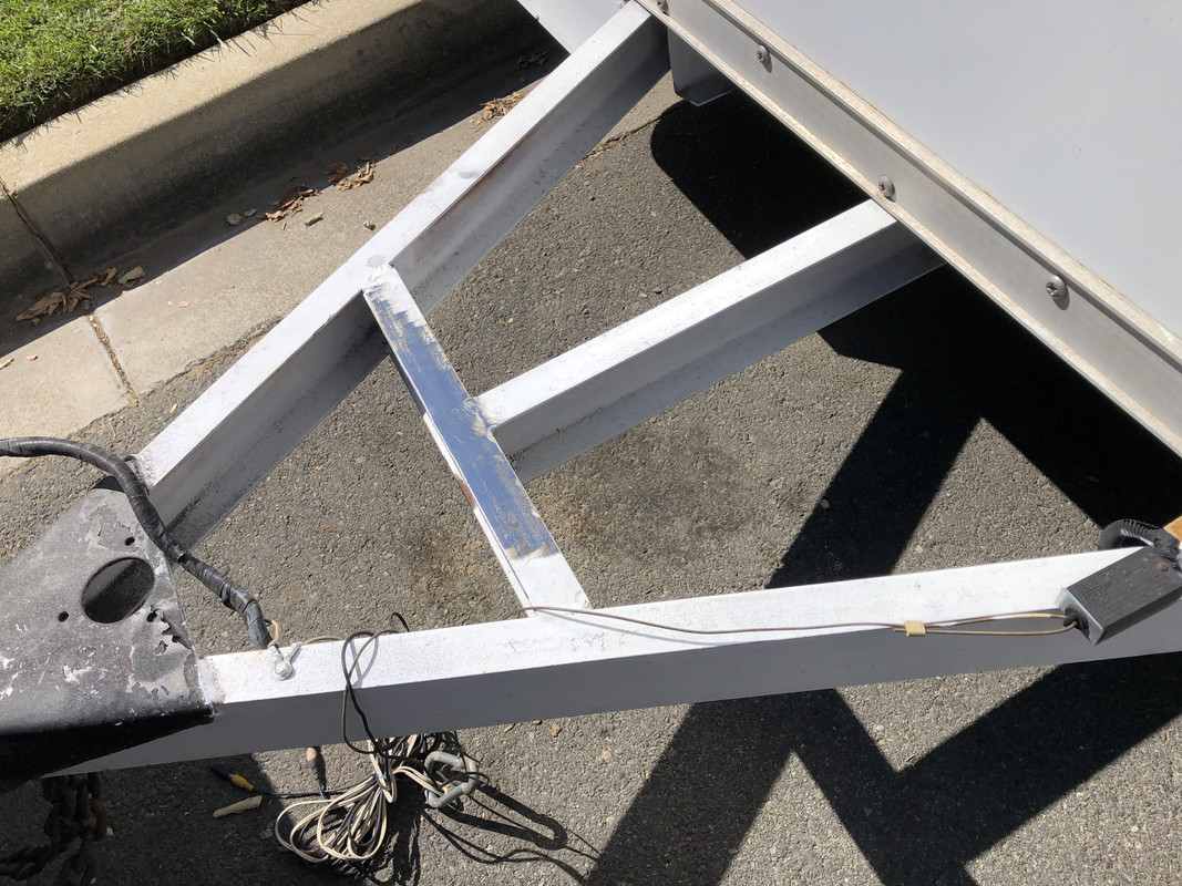

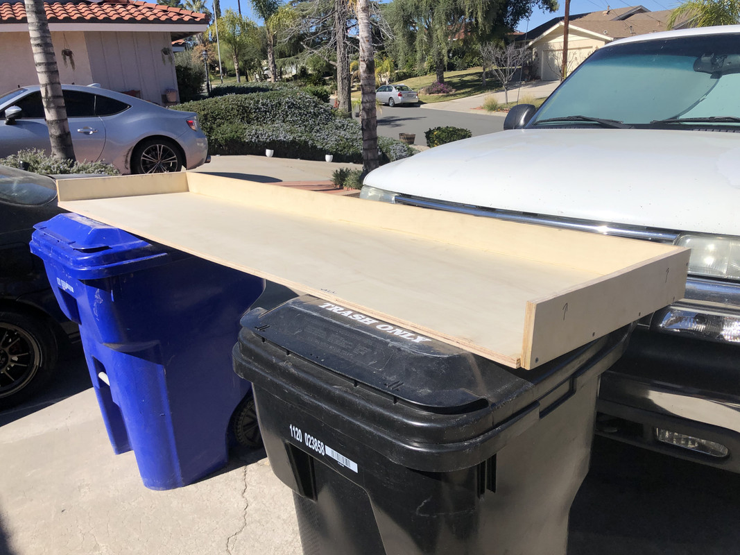

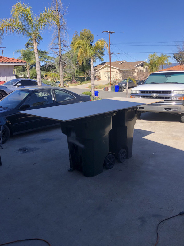

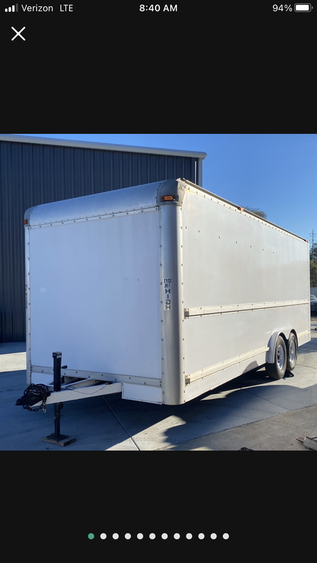

First thing I did when I bought my box trailer was build and install a shelf for the front to hold equipment, tires, etc. Dont have a ton of pics but it is on brackets that can collapse allowing the bench to fold flat if I want it to.

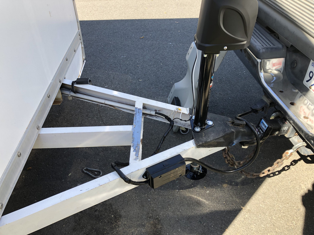

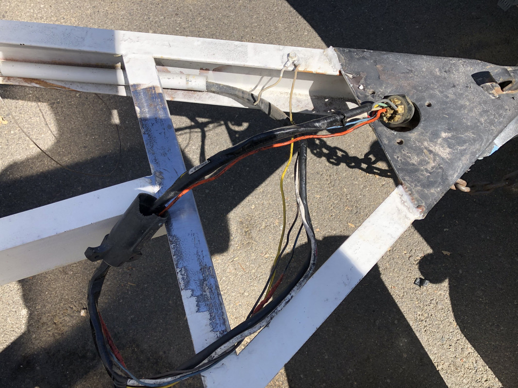

Then went and added an electric jack.. had to cut off the manual one as some buffoon welded it to the tongue. Also went in and added a 7 way junction box and replaced the plug.. old one was done.

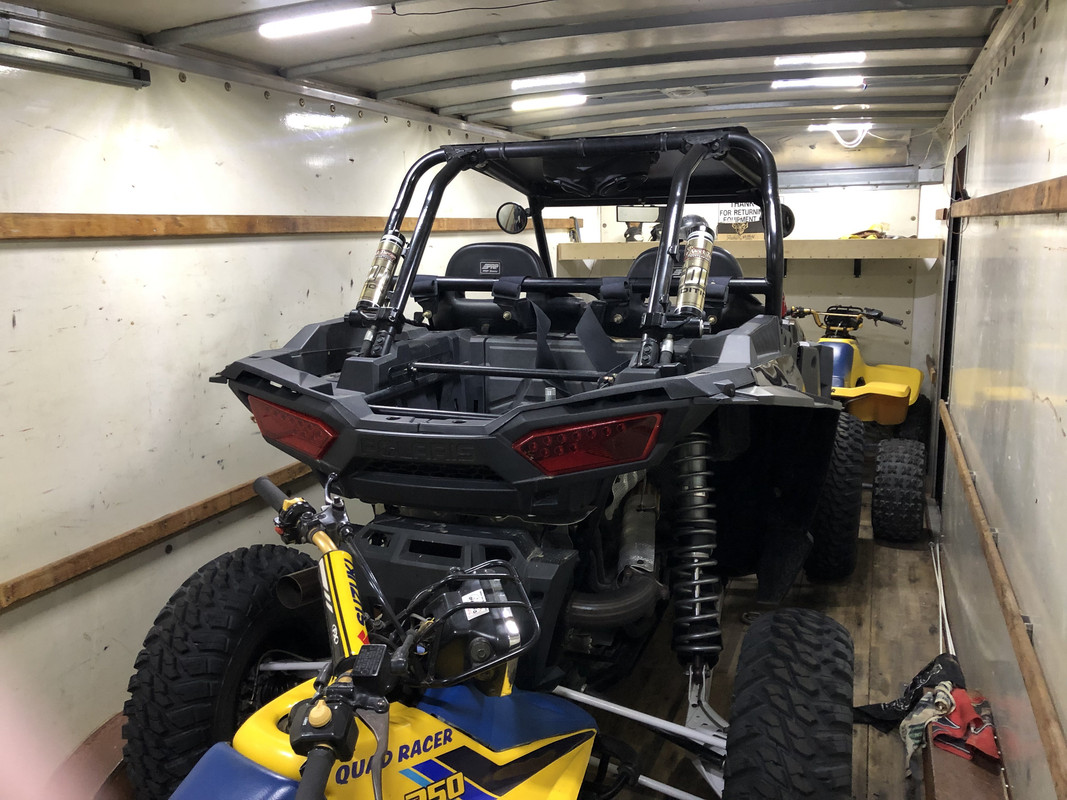

Recently added some cheap amazon LED lights... they are bright as ****!!! No battery yet on this trailer so I have the junction box wired so my electric accessories are powered by the 7 way. Works just fine and im not sure ill even add a battery at this point.

Super nice trailer. The rub rails are a great addition. Lights look awesome.
I love the idea of 12v LEDs in the trailer. I’m married to 120v lights at the moment
