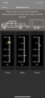

Looks like you have a great WDH and your truck has some innate sway control built in. If you’re still experiencing excessive sway, as others have recommended, you may want to evaluate and adjust the WDH setup. I pasted a link from the Fastway company below that explains how it well. You may also want to give them a call. I’ve called in the past and they were very helpful. I also pasted a link to the Curt Betterweigh device and one of the several YouTube videos that shows its application. It plugs into the OBDC port and works with your smart phone ... is absolutely worth the money. It’s easy to setup and relatively cheap ($99). Once you have it calibrated you can use it to get tongue weight, weight distribution, set the brake gain and a lot more. I use it every time when hooking up to the TT to make sure I’m where I should be. It’ll give you an idea until you can get to a CAT scale if you want. I inserted a pic that illustrates the weight distribution function from when I was hooking up. I take screenshots every time I tow as references to see if something has changed since the last hook up.
