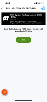

Curious how to program a key fob with JScan.. i see i have an option to enable remote start in the BCM configuration.. but i can’t find how to program a FOB to my truck.. any help would be appreciated
Adaptation to radio job frequency settings…
Pull code….
Then fobik programming, it usually gives a 5-6 digit pin. Only use the first 4 digits I beleive…
