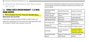

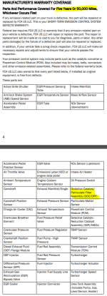

Anyone know what the warranty is on the DPF? Some places say 3yr/36k, some say 5yr/50k (Federal Emissions Warranty) and some say 8yr/80k (Federal Emissions Warranty). My 2022 RAM 3500 goes into passive Regen every 75-150 miles. I leave the DPF gauge up so I know when it goes into passive Regen every time and always let the cycle complete every single time so I've never had the P2459 code but I'm sick of it. I have used Archoil at every fill up since new, change the engine air filter (no glue strips) every 6 months, and had the correct MAF sensor installed. I'm at 38K miles and because of the TSB may just stop paying attention to the passive regens, let the DPF fail, get the P2459/CEL and have the DPF replaced but want to make sure it's covered.
I’ve wondered the same if anyone knows for sure. Here’s the ChatGPT response:Anyone know what the warranty is on the DPF? Some places say 3yr/36k, some say 5yr/50k (Federal Emissions Warranty) and some say 8yr/80k (Federal Emissions Warranty). My 2022 RAM 3500 goes into passive Regen every 75-150 miles. I leave the DPF gauge up so I know when it goes into passive Regen every time and always let the cycle complete every single time so I've never had the P2459 code but I'm sick of it. I have used Archoil at every fill up since new, change the engine air filter (no glue strips) every 6 months, and had the correct MAF sensor installed. I'm at 38K miles and because of the TSB may just stop paying attention to the passive regens, let the DPF fail, get the P2459/CEL and have the DPF replaced but want to make sure it's covered.
That's what I found too and online it says the DPF is covered by that warranty. I'll call RAM to try to get confirmation tomorrow.The warranty supplement for my 2022 lists the federal emissions warranty as 5yr/50K miles.
