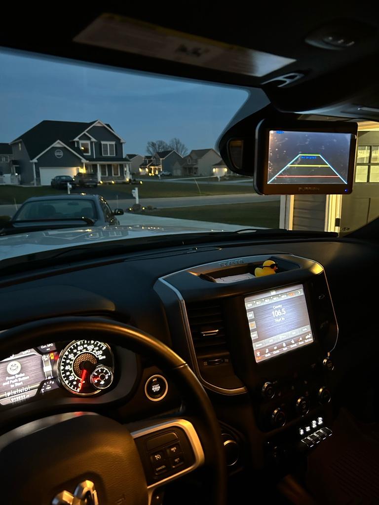

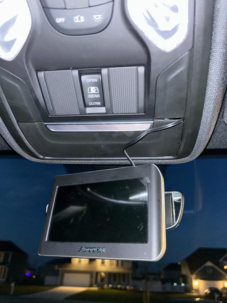

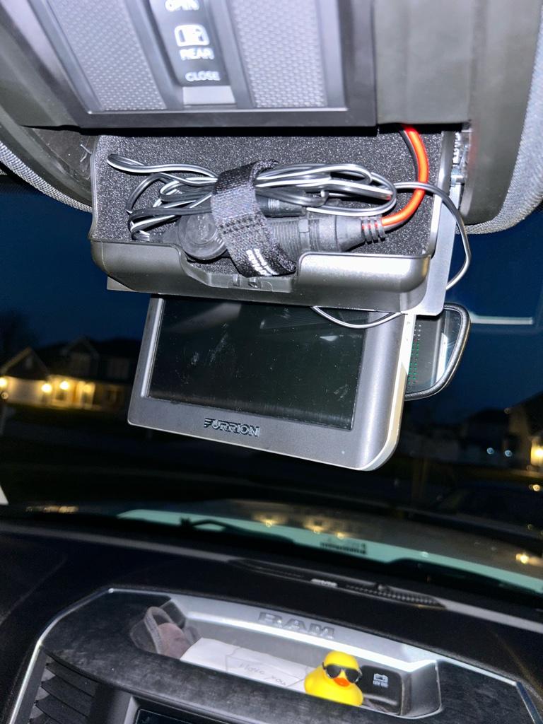

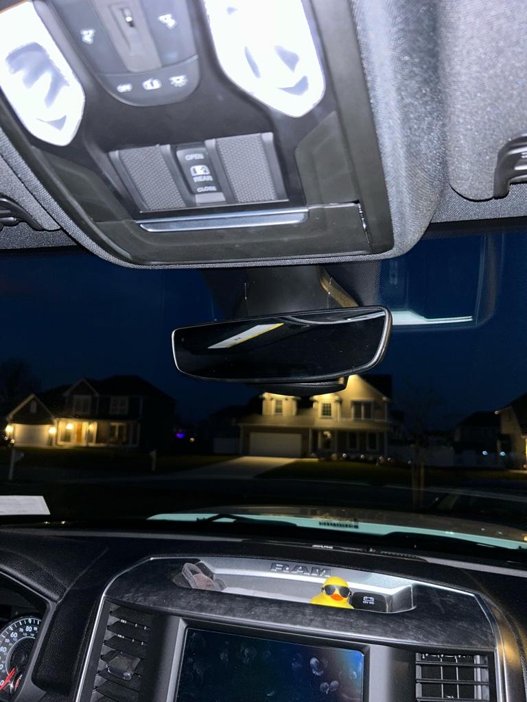

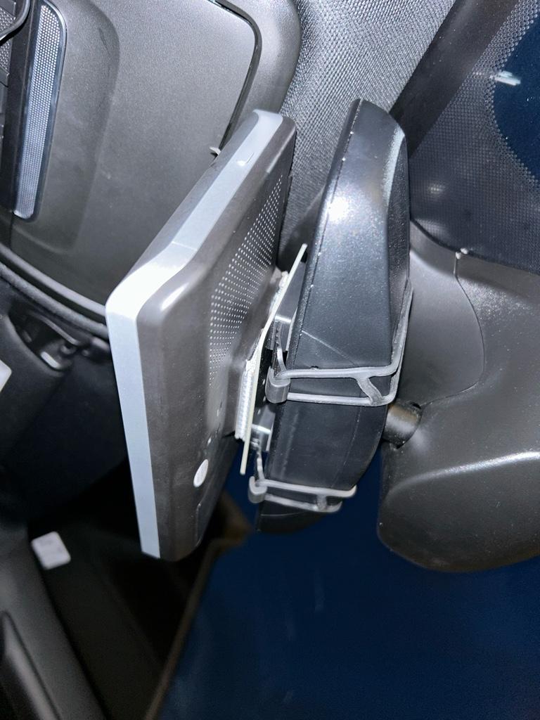

Got my Furrion 7” display rigged up to take place of the mirror when hitched, since it’s wasted space anyways. I used the Haloview mirror mount with some heavy duty Velcro to the display. For power, since I wanted to use the factory cord, I tapped into the overhead console wiring with a marine grade fused 12v socket. It all tucks into the sunglasses holder I never use so it’s out of sight. I don’t care for wires all over. OCD

Haloview mount and Velcro to the Furrion screen.
12v socket.
Tow mode.
Non tow mode.
