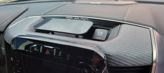

Can you take a pick of how the rubigrid is mounted on that dash, top-view?

Not without taking it apart. Basically under the rubber mat in the tray, there are two screws - the only things holding the 12" screen in place. Insert Rubigrid and re-use screws through the pre-drilled rubigrid holes.
Sorry I mean, take a pic as it is , but top-view

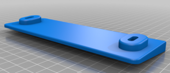

The Rubigrid was tight up against the dash cubby so I designed and 3D printed a base in PETG to tilt it back and up a little. Fits in the detents perfectly. Use the supplied tape to mate the Rubigrid to the base. I didn't use any tape for the base to cubby and haven't seen any issue with just the screws holding it. Heavier total weights may want to add tape to the underside of the base.

Thank you! I just pulled the trigger on the Rubigrid even though it says it doesn't work with the 12" screen (but seeing the other example here where it does makes me feel better) and I'm having your design printed up now.

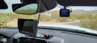

This is a pretty slick item. Might just have to get one myself! For now, I mount the screen for the rear view on my 5th wheel so it's just sitting on the dash. Tried it higher, but seemed to interfere with vision too much. One very useful thing I've found with the rear cam view is knowing when I've passed someone - it gives a superb view of what's behind me while driving.
