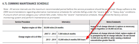

I hear ya. Following the MFG recommended schedule. I don't run bio-diesel (12k OCI), so I went with the 15k OCI.

The pumps I regularly use don't have biodiesel stickers, but it's impossible to know for sure if it's blended. According to the US Dept. of Energy "Pumps dispensing biodiesel blends of 5% (B5) or less must include a label stating that the fuel “may contain up to five percent biodiesel” and those distributing blends greater than 5% must be labeled with the capital letter B, followed by the numerical value volume of biodiesel and the words “biodiesel” or “biodiesel blend.”
Moving forward I'm going to ignore the owners manual and move the OCI from 15k to 5k.
