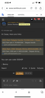

Ok so Benny at allmoparparts said he can't find a part number for the LED light so he's thinking it's part of the tailgate harness which has it's own number exclusive to the 2022MY. The part number is 68521314AA which unfortunately is currently unavailable for order and unpriced... I'll post back here when I get any updates on it.

I received the tailgate handle today but it does not include the light does anyone have the part number for that light
wow and i just ordered the harness it will be something different from 2020
Finally got the part number for the light itself!
