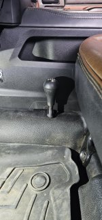

Transfer case shifter:

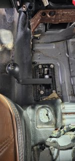

The Manual transfer case was definitely the big hurdle for me. The factory shifter is located directly beneath the HVAC ducting for rear vents … so unless you cut a hole in that and the console…

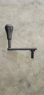

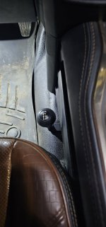

I custom made an offset transfer case shifter, by cutting off the solid rod shifter, welding about 5.5” long piece of 1”x1/4” flat bar on, and then welding the shift lever rod back on, about 4.5” C-C from the original location. I wanted to keep the shifter about the same height, I used the factory bends to get a bit more clearance from the console. 4Hi is a bit close to the seat, and could be an issue if you have seat too far forward.
Custom shifter:
