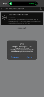

I have a 2021 Ram 2500 Cummins that I am trying to update the tire size to 37”. After updating the tire size, clearing any errors then running “ABS - Full Initialization” (Trucks is level the ignition is in the run state) I am getting the following error. All errors clear but the ABS light still blinks.
Any ideas?

Brand/model OBD reader?
Clear errors in ALL modules?
