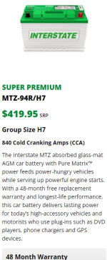

Long story short. We parked the truck for 3 weeks because of travel. My wife tried to start the truck and couldn't. I just tried to jump it and it wouldn't. They are dead. A couple of questions:
1. Is this expected behavior?. Do I need to take it to a dealer and have "this issue" fix? This is a 2023 Laramie.
2. I read that OEM batteries are not that great, what are the best options for replacement?
Thanks a lot
H
3 weeks of sitting without a maintainer is no surprise they went dead. The second AGM you listed will be plenty for your needs

can you expand on why that one is better?
The one you posted is a good unit aswell i have one of the same brand on my backhoe it was free as it was used and it has been a solid unit for the 8 years its been in use by me
Price/performance.
I have both brands but all my "Tender" brands are just the small battery models. The truck gets the NoCo stuff.
The NoCo is also a better setup IMHO to (semi) permanent mount under the hood as it comes with a velcro strap/bracket. Rescue and override mode to charge "dead" batteries.
