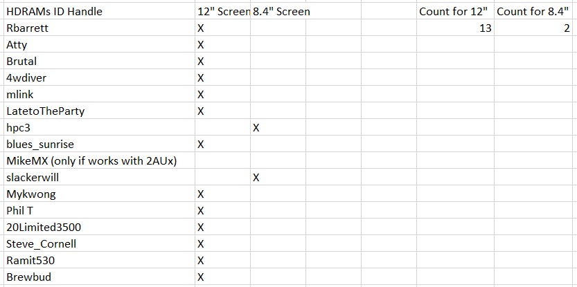

I am interested in the group buy. I have a 2020 with the 12"
@Atty please ad me to the list for a 12" if you have not already., I mentioned it earlier, not sure if you caught it in my post... Thank you!
Thanks Ramit530, you're added.
Here's the updated list.
