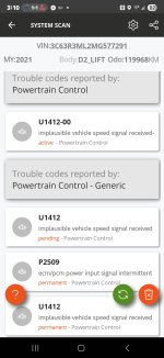

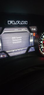

Ok guys I need help I followed all the directions in jscan. I know this is alphaobd but I see other people post about jscan in here so I figured more people might see this. I typed this out and I believe it's accurate sorry I'm beyond super frustrated for the last 36 hours.
Ok everyone. I have a 2021 Ram 3500 SO Diesel truck. I added the the kaodtec gateway bypass cable. I also have le4.0 obd2 adapter. I wanted to change the tire size to correct the speedometer since I upgraded to 35s in the last couple months. So after I did this I got a a bunch of errors and the I tried like the app said to intialize the abs. Then I restarted the ecus because I read that on their site and now my truck won't start at all. I found the recover tab today and performed this and also used the abs+esc disable for 1 key cycle. Now my truck will start at least finally and I have cleared the codes a ton of times now. But I still am throwing these errors every time I start the truck.
Thank you in advance for any help I really truly appreciate this.
Hmm.. 'implausible vehicle speed signal received' would maybe indicate to me a bad value input for the tire circumference? It should be in MM. I just updated my truck, 315/70R17's, as 2742mm. This tire calc helped me, but it doesn't seem to support 35's or 37's as a denominational size. So i would go to Tirerack or Discount Tire, find your tire size and see what they list in the specs for diameter, then input that here and make sure the input/output are configured correctly (likely inches for input, and MM for output) and try again with that circumference. Note that second calculator gave me a slightly smaller circumference when i put in the listed diameter for my tires (34.4") vs using the first w/ 315/70R17 - 2745mm vs 2742mm, I went w/ the lower.
Also, make sure you also follow the steps in this thread and change the circumference in both the 'set tire size' and for the tire size for ABS as well. I also just added (at the end of that thread) Brutal_HO's great step-by-step for clearing the errors after updating those two.
