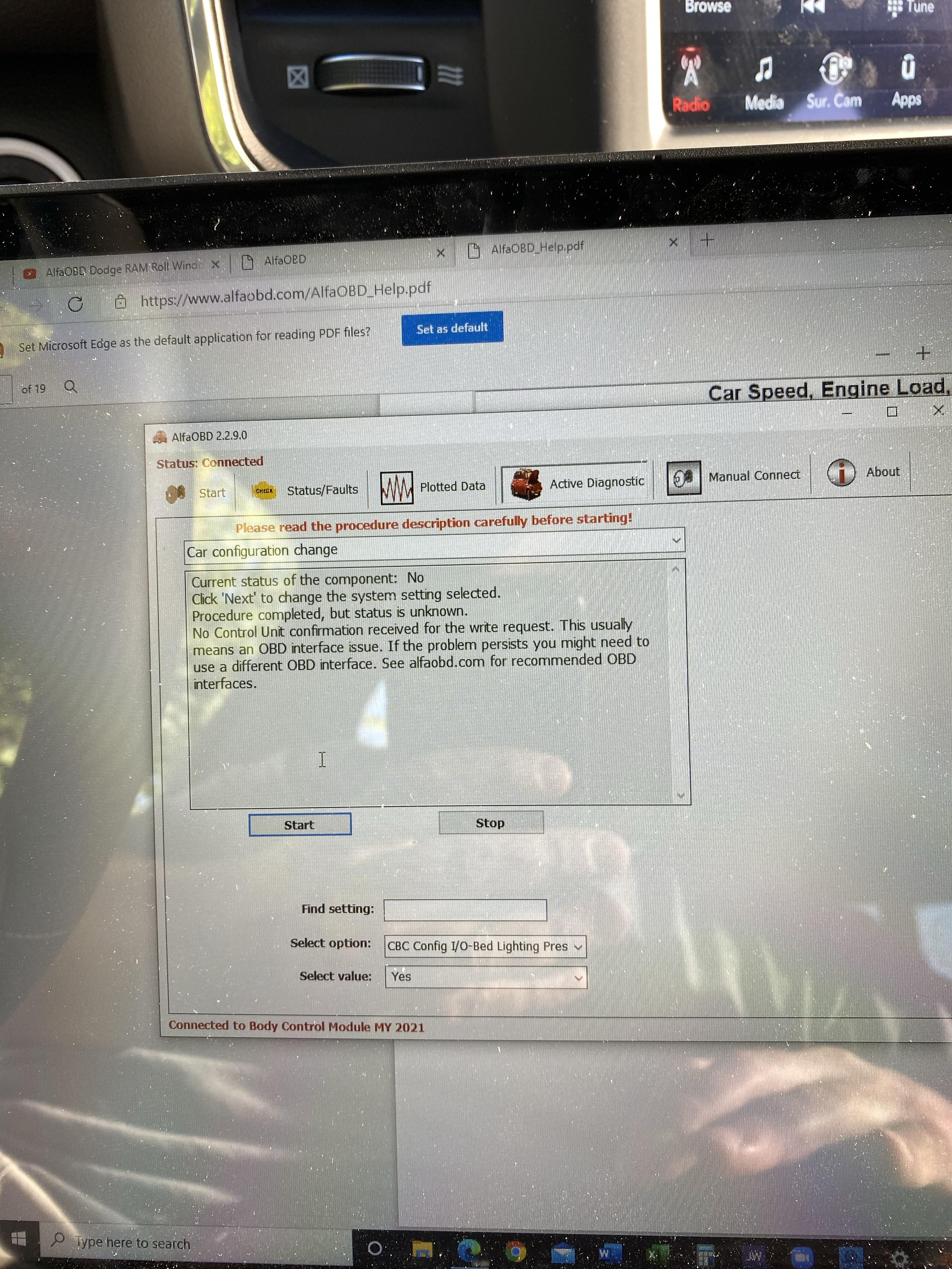

Great point. If anyone that has this working, particularly in '20 and '21 MY can post their config files, I'll see if anything jumps out.
Trail cam (Fwd Cam/PW Cam) worked for me first shot. 2020 Big Horn. Just enabled it and got it to go second key cycle in my buddies 2020 Tradesman.
Configs attached.
