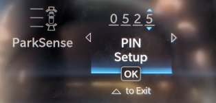

I had fooled around with that but ran into "pin setup" - I didnt want to lock myself out of anything so I aborted that exploration. I'll explore the commercial settings at lunch and report back.
You don’t need to set up the PIN, just enter the zeros. If PIN setup is all you see, then aux switches aren’t present.
As you may have anticipated, all I get is the pin setup and the parking sensor. My menu item is #7, while yours is #10. So There's probably other stuff I dont have due to our difference in trim levels (I'm Laramie L2+)
Your commercial settings menu has parking sensors? Are you in a chassis cab?
You mean pin setup and backup alarm?
I'll confirm, but it was two options (it probably was backup alarm).
I honestly should have got a snapshot, but I was literally running out to the truck between calls. Sorry for the sloppiness, I'll confirm after work.
Only 2 options:
Park Sense and Pin Setup

Weird they have ParkSense setup on there. Previous model years only had that if you had a chassis cab or bed delete (or enabled it in AlfaOBD of course).
The only options inside ParkSense are to turn on/off for front or back. I was hoping for a sensitivity setting... the sensors are def more sensitive than my 23 was. Hoping to tune it down.
Yeah, those are the same settings that the trucks I mentioned have. It's because they ship with the system only partially installed and they give you the options in there to turn it on if you install the rest of the sensors.
