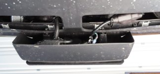

I also made a bracket to mount my battery tender behind the bumper. Hard to see in the picture because everything is black.
The red square shows approximately where the battery tender is behind the bumper.
