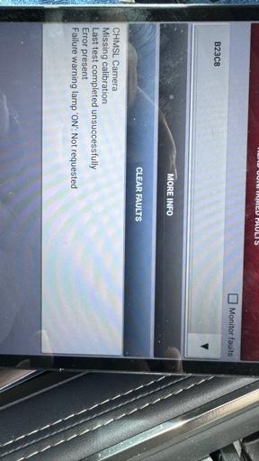

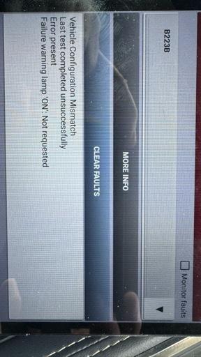

I get two faults. B223B and B23C8.

A 2022 CVPM - This requires you to reconfigure your BCM‘s MODEL Year in AlfaOBD to match It. That’s why you’re getting a mismatch code.
Just read through it again - so you should have:
A 2022 UC5 Radio and Screen (requires nothing specific in ALFa)
I’ll add a picture of the setting - but it’s under BCM - Car Configuration Change - then choose the 2022 model year, and then go clear codes on the CVPM and calibrate…
I connect to Body Computer, MY2022+ PowerNet, and I get back “connected to body control module continental MY2020”. I head over to car configuration change. Model year I set to 2022. Get it to where it says : Current Status of Component: 22
I’ll try and calibrate tomorrow when the sun is back out.
That should do it -
What I found worked the best - Clear CVPM codes from Status page, then do one of the side cameras, "disconnect, then reconnect to the Radio-CVPM" clear code, other side camera.. then same dance to Front, then rear...
