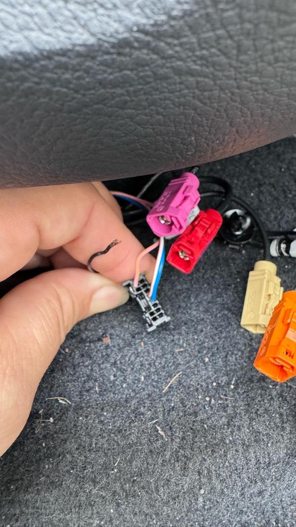

I did. But I saw this as well. Happen to know which pin it goes into? I have new connectors to recrimp now. But where does it go?
Whelp. I don’t have the right connector. I’ll order it. And just putting it in there didn’t make a good enough connection . I’ll update after I get a new connector.

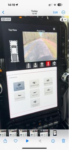

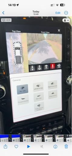

I have mine all working. Cameras go through calibration. It shows up 360 on the screen looks great. After a few seconds reverts to all black around the truck. Any ideas?
When you reset the errors on the CVPM then re-cal a camera - it goes "good" for a second until the error flags again. I'm guessing you might have 1 camera that is not calibrated. Run the sequence, do Left, then Right, then Front, then Rear....and clear the CVPM error each time....
I didn’t clear the code each time, because it doesn’t throw one. Not sure what I’m doing wrong. I did each camera one at a time. But it keeps saying no errors?
Go reconnect to the radio, and then select Central vision processing module, and then go to the status and fault screen read all faults and then clear fault. And that should bring it back to operating normal if the cameras are calibrated.
