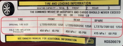

Okay, finally found a 2500 Limited near me that I could drive and view the payload sticker. The news is just awful; 1,990 lb payload.
152
2019 RAM 2500 SRW 4x4 Limited Crew Cab 6"4" Bed
+Delmonico Red, $100
+Towing Tech Grp, $445
+Protection Group, $95
+5th Whl/Gooseneck Towing Prep, $445
+Body Color Bumper, $395
+Limited Level 1 Group, $2,995
+Anti-Spin Differential Rear Axle, $445
+6.7L I6 Cummins Turbo Diesel, $9,100
+Power Sunroof, $1,095
-RamBox Delete, -$490
MSRP: $80,520
With our trailer's GVWR of 11,000 and 1,600 hitch weight, there doesn't appear to be any way a 2500 Limited is going to work for us as we'd only have 390 lbs of payload remaining. While we don't need the 5th Wheel / Gooseneck Towing Prep, we would like the RamBox, extra alternator, auto level air suspension, and deployable bed step. Does anyone know the weight of the sunroof or 5th Wheel / Gooseneck Towing Prep?

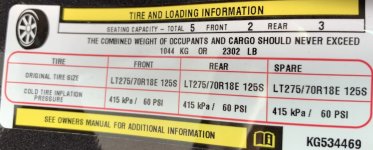

Here is a Big Horn and the payload is only about 15% better than the Limited above; 2,302 lb payload.
153
2019 RAM 2500 SRW 4x4 Big Horn Crew Cab 6"4" Bed
