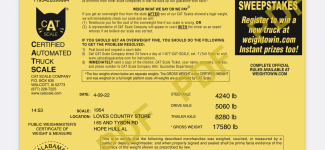

Scale ticket from beach trip, home leg. Truck and 5ver are a pretty good match.

My 2019 3500 SRW HO Big Horn 4x4 by door sticker says 12,300 GVWR. So my big boned truck is 5100lbs steer, 3560lbs drive, for a total of 8660lbs (I remember when cars weighed more than 3000lbs they were considered fat). The mods are a 50 gallon titan fuel tank nearly full at weigh in, and a camper shell on the bed, and full DEF. So of my original payload (3960), I have 3640 left. Which is what one would figure from expanding the gas tank and putting a topper on the back. I was not in the truck and the truck was practically empty, save maybe some papers proving I purchased it.
But I would say, my truck matched its payload sticker. Its just easy to forget how much "stuff" we add to trucks that eats up the already constrained payloads. Payload is what most people run out of 1st on a truck.
