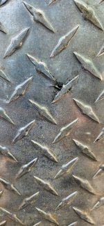

Realistically, probably not enough to be real noticeable.
Looks like an outy, not an inny. Like someone jabbed it from the inside.
Did you install any Rubber strips under the Tank?

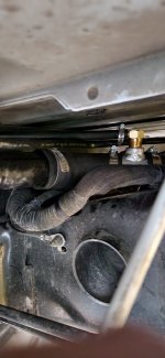

Looking forward to reaching 30k miles. While I'm changing out my transmission fluid, I will be adding this little guy to delete the thermal bypass to the transmission cooler. Mine has already stuck more than once causing a spike in transmission temps.
I have been wondering the same. Its a worth while upgrade i have had mine stick in the winter when plowing and saw 230° that would not drop unless i shut the truck off for a while it should have come down while in park and high idleI'd like to find out if the Mishimoto one listed for 2013-2018 works on the current AS69RC. can't imagine it won't.
Thermal Bypass Valve Kit, fits Dodge Ram 6.7L Cummins 2013-2018
The transmission is the backbone of your 2013-2018 Dodge Ram 6.7L Cummins. It's responsible for transmitting up to 930 lb-ft of torque from the engine to the wheels. That much power generates a lot of heat and if that heat isn’t dissipated it can destroy your transmission. The transmission...www.mishimoto.com
When only the strongest will do.Ahh smart……emergency tow rope.![]()
With the bypass my temps are down to 140* so far which is a big drop.
