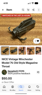

Found this used one on eBay.
Magazine tube feeds in from the left. Barrel would be on the right
The little hook you see in the middle top is the ejector. Second Gen ones the ejector bolts on to this piece
