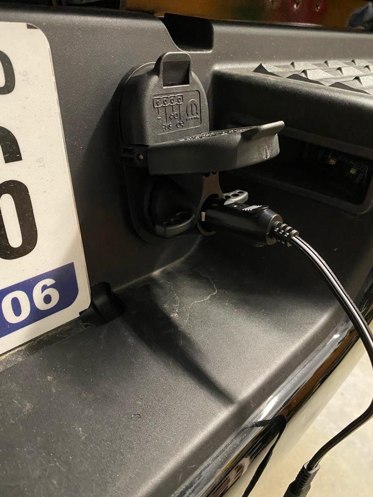

I just realized I can charge both batteries from the rear bumper with my 7 way to 12vdc adaptor. Then I just plug in the tender with the 12vdc port adaptor. Now I don’t have to worry about wiring up a connector off the batteries.
Ha as a bonus, the day I forget to unhook before driving off, it will just unplug as I roll away! (I know I will forget sometime)
