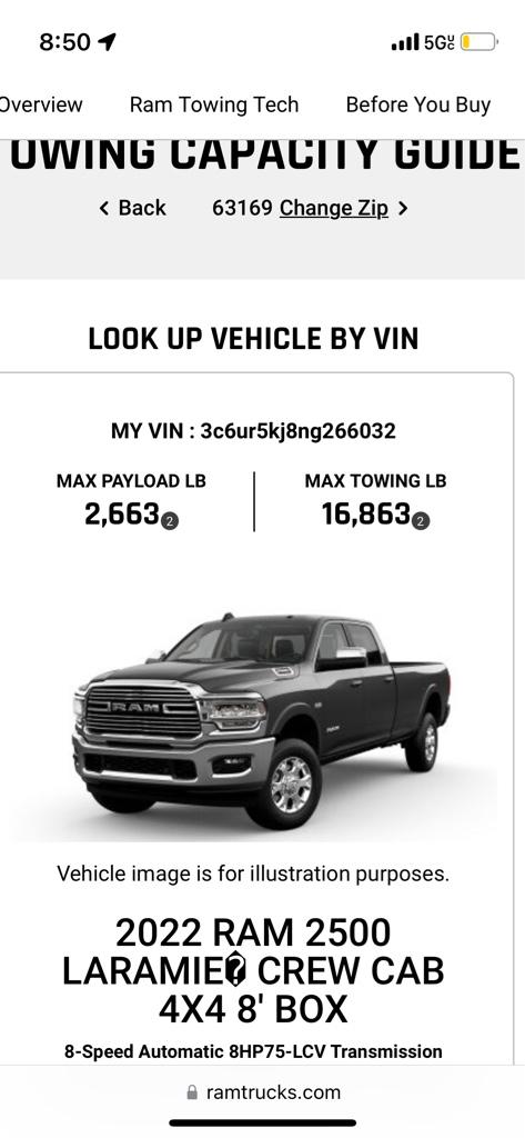

I just took delivery of my 2022 2500 CCLB Hemi with 4.10 and 50g tank. (Two weeks tomorrow).
I haven’t towed with it yet, and only have 1236 miles on the clock, but am very happy with it so far.
I was nervous about the length and living in a busy metro area, but I can run it through the local Chick-fil-A drive through, so it passes muster
Mileage is actually slightly better than I expected with the 4.10 axles and long bed. 11-12 around town with tons of very short trips, many cold starts, and lots of traffic lights. 16+ on the highway. This driving situation would be devastating for the CTD.
And my towing capacity is approaching 17k!! It’s a “base model” Laramie with very few options/additions.
I would not hesitate to order the same truck again, with the 4.10 (and a Hemi)..

17k lbs! Wow. I'd love for you to hook that load to the truck and give us your thoughts.
It would probably get about 3 mpg and get outpaced by a turtle. I doubt that I’ll ever haul more than 6-7k.
