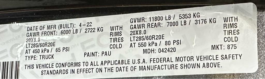

I tried going through the payload thread. But it seems most everybody only posted the tire and loading sticker
Can anyone post their other sticker like mine above.
Would be great to get gasser and diesel.
Regular, plow prep and snow chief

2022 3500 SRW CC Limited with factory airbags and the Snow Chief Group.
Sounded like you were looking for photos from different trucks with different packages to compare….
The axle weights on all cummins trucks and hemis wont change with the pkgs i was more meaning spring p/n for the front coils sorry

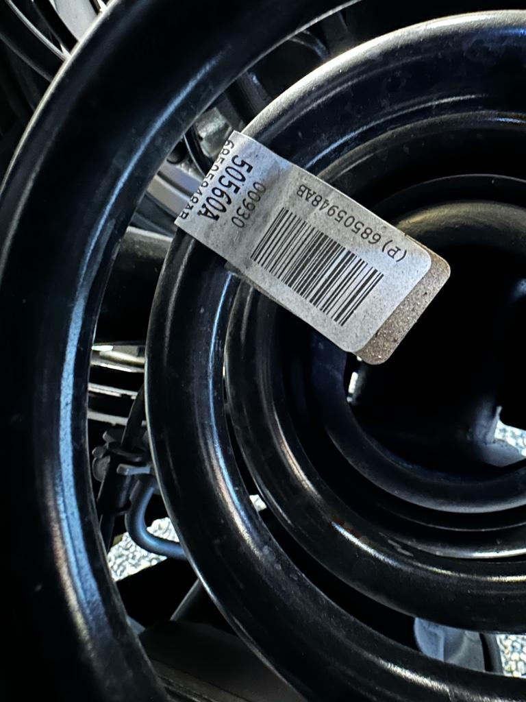

There is a tag…
My truck is also a 2022 3500 Bighorn 6.7 CCSB SRW but I did not order it with the Snow Plow Prep Group nor the Snow Chief Group but has the same springs on both driver and passenger sides as yours 68505948AB.
