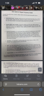

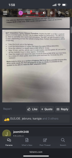

Yes, do the MAF relearn in-between regens.
IF your DPF is face plugged as mine was, nothing is going to fix it. Consider having the DPF bore scoped. It takes a very small, and expensive, borescope to get in there. It is what if is, if face plugged, get if fixed. Look around, sometimes people delete their trucks and have good used DPF,s available, but they are heavy and hard to ship. It cost me $2500 at the dealer to have one installed. Or delete, but I like the clean smell of my trucks exhaust.
It was doing to many short drives, along with the air filter debacle, that eventually led to a face plugged and ruined DPF.
