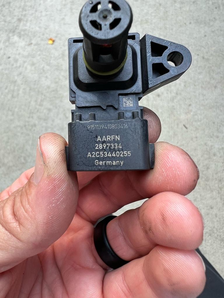

There’s been a lot of talk regarding this. Supposedly there’s two suppliers for them. A German one and a Chinese one? The Chinese manufacturer is supposed to be “better”. Not sure what is better, but maybe it’s a more stable sensor? My 2022 HO has the German one.
I talked to a very good ram diesel tech last week and was told that anytime they work on a 2022 Cummins truck with a regen frequency issue, their standard practice is to replace the MAF, differential pressure sensor, and the exhaust pressure sensor before they go any further.
That’s funny you say that. Because I have the German one.
Just to be clear that is your MAF. I’m showing you my MAP sensor. But my MAF is German also.
Yeah sorry I guess I missed that initially. The techs I talked to all said they change the MAF out. Not the MAP. But the MAP would also make sense. I’m not sure which version of the MaP I have but I’ll check tomorrow.
