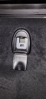

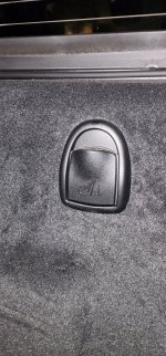

Can you post a picture of the back wall anchor on your mega cab?
With my rear seats being modified to fold down I think it would be possible to mount an anchor point on the back wall.
It’s pretty much just a change of direction for that anchor point. Seems to make it a bit easier to tension imho. I use it for a seat when we are on our family camping trips.
