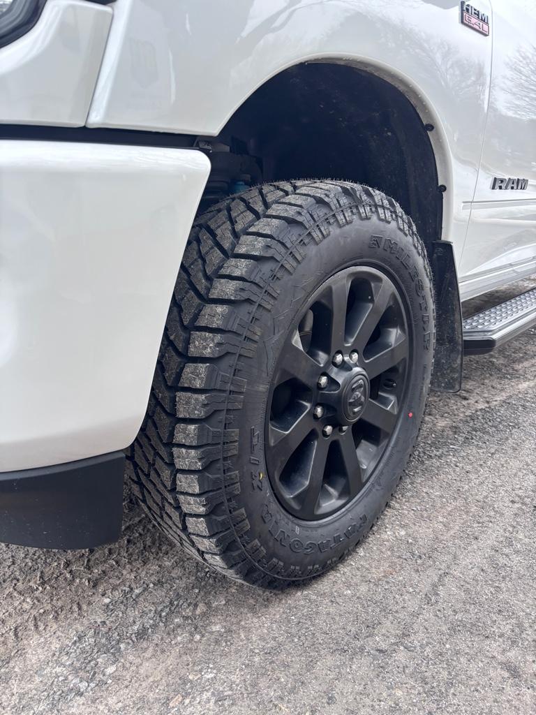

I just went through this whole thing over a few months. I do tow a 5er. I do have bags on my ‘21 CCSB Big Horn gasser night edition with factory 20’s to help level when hitched(people already don’t like the LED headlights when hitched after dark but too bad). I went 31k on the 285/60/20 Transforce tires with minimal complaints. They weren’t great tires but I suppose there may be worse out there. I didn’t want to level. I didn’t want to lift because the 5er is almost heading nose high as it is with the best hitch ever(laugh please) in the lowest setting. I need a tire great on pavement, good in snow, handles my crappy stone driveway with an incline and didn’t break the bank. I went with 275/65/20 Milestar Pategonia X/T. They supposedly measure 34.4”. Is that mounted or not? I don’t know how they figure that. What I can tell you is they are substantially larger than my worn out Transforce tires. I have zero rub, including lock to lock. It still fits in the local wash(it was close to max height prior to new tires) and the tires seem great so far. I only have a few hundred miles and no snow time yet but they have to be better than stock in that dept. Yes, I went narrower but taller, picked up a few hundred pounds of load rating if it matters and have a tire that actually has some tread. I’m not trying to sell you on anything. Trucks can differ. You have 18’s I have 20’s. I feel the 1” spacer will level you just fine but you may be looking into the Thuren front end parts to alleviate any rub that comes from going wider. I’m not fascinated by wider. I’m fascinated by efficiency lol. Best of luck. Rant over. Just figured I’d share in the madness.
