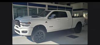

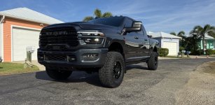

First pic was how the truck was and the rest are the new look. Still at the dealership hopefully will pick up tomorrow.
Added Carli torsion sway bar and upper and lower stabilizer. Also foundation wheels on 37’s. Crazy how 35’s used to look so big and once I installed them they looked tiny to me. Hoping the 37’s will be it

Interested to hear if the 37's rub

Ok so a little update. Truck is still at the dealer. I was having an issue with the def system so they had to order a new tank which caused some delays.
The tires do rub on the fender liner quite a bit. They are going to trim it and should be good to go. I’m running a +19 offset as I didn’t want too much poke considering my truck didn’t come with flares. I think if you have flares and go with a 0 offset you might be fine
Also fwiw when I first asked about speedo calibration for bigger tires I was told no one offered anything for 25’s. If you are wanting to go bigger tires but this is stopping you talk to your dealer. Mine did it for $150. First time on 35’a and now for the 37’s. Hope that helps
Finally picked it up and got a chance to take some pics. Drives way better now with the Carli torsion sway bay. Fender liners needed to be trimmed about 4 inches on the back sides and pinch welds had to be also. Dealership took care of it all for me as there was no way I was going to drive home with how bad it sounded.

White was a good choice. The new front end looks good in white.
