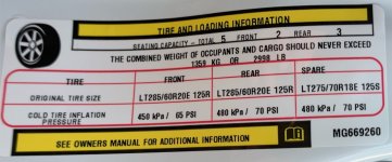

So here's a mystery... Why the heck does my sticker look different from everyone else's? For reference, it's a 2021 2500 limited with the CTD.
Sent from my Pixel 3a XL using Tapatalk
That's a different sticker.
Look for the yellow one on the truck part of the drivers door jam. I.e. open the drivers door, facing the truck, and look down and to the right.

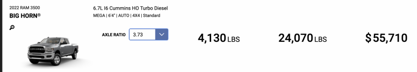

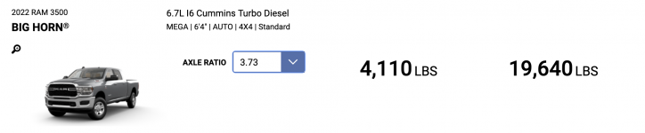

I searched and i didnt see the link in any posts
Found this today
wonder how it compares to the actual stickers on the doors.
It will either be a maximum based on vehicles with no engines, or it is based off of the options that are selected a certain percentage of the time.
If you put in your VIN, then it was accurate at one point...but I think it has gone to crap again.
based on options, it has cab, bed engine and then you can pick final drive ratio.
Non-HO 3.73 (SRW), HO 3.73 (SRW) and then HO 4.10(DRW) - so i dont think its a generic value.
Screen Shot 2022-05-09 at 21.15.19.pngScreen Shot 2022-05-09 at 21.15.38.pngScreen Shot 2022-05-10 at 08.53.42.png
Those I would call configurations, options are going to be like off road group, snow plow prep, ram boxes, etc. etc.
I don't disagree. Its the closest ball park I was able to find this far, vs some other locations that have more generic details that dont add up or make sense honestly.
Outside of this, paying $10 and going to a scale to know what your actual weight is and then calculating the reverse from Tire load charts, total capacity and total payload the specific setup was designed for.
I do like how this page distinguishes in the search based on kind of truck, then engine, Cab, Box, Driveline, and SRW/DRW (via Axle ratio).
this one made less sense to me, so i shared.

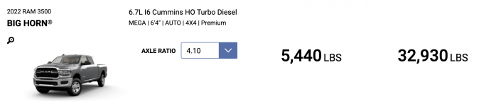

The site isn’t accurate based on my door jamb sticker….for my VIN the site says 2640 (or something like that), my sticker says 2778 (2022 2500 6.4 mega). I’m going with the door jamb sticker. Also, the dealer had all 4 tires at 82 PSI when it was delivered to me while the sticker wants 60 on the front and 65 in the rear. I’m going with the door jamb sticker. Even fully loaded for camping and tested on the scales, I could conceivably come down in tire pressure based on the tire load charts, but for now I’m using the sticker as my guide. For the record - I’ve got over 700 pounds of cargo capacity remaining fully loaded for camping. If RAM would offer a 50 gallon tank to replace the 31 gallon tank - that would only eat up less than 200 pounds of available capacity. I’d GLADLY give that up for the extra distance. 31 gallons at <10 mpg when towing….yikes!! Different thread for that though…
