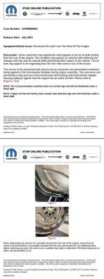

The fluid on the engine adapter plate and inspection cover of the Transmission may be the CATS rust preventative that they spray on to the block for shipping and storage protection. I would recommend wiping it off with a degreaser or solvent and then see if it returns. View attachment 71561
Man I sure hope so. Mine is on a lift getting the 10k mile oil change and that is what I've got...
It's very thick & tacky like fifth wheel grease, with no odor.

Hit it with a black light and see if it illuminates.
Clean it off really well with a good degreaser and see if it returns. The amount of it you’re seeing is more than what I’m typically used to seeing, but it could’ve just been an unusually heavy application of it. See what happens.
Also, take a really close look at the back of the engine block where the adapter plate bolts to the block. Follow the union upward on both sides of the block and see if there’s signs of oil leaking down. There were some trucks that had flawed gaskets on the valve cover and rocker box, and both would allow oil to weep down the back of the engine. It wouldn’t be easily visible but definitely happened. Mine was one of them.
