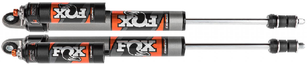

Got back yesterday from my day trip out to the western part of the state to The Spartan Garage for a second opinion of my issue. These seem like good guys. Young, ambitious, and really willing to build a relationship.
They tackled my issue with the zeal I would expect...and without me in the cab took one trip out to a pretty rough section of road. Came back and put the truck on the rack and proceeded to check out the suspension install as well as reaction to push/pull on springs and shocks. After the review and noticing how "loose" the rear was at ride height, they went out one more time...came back and loaded about 3 mounted 37's in the back (ballast, I guessed) and back out again.
Upon that return we had the discussion and I decided to try these to see if I can dial out the issue. They should be here before Christmas. The 2.0s are just not working with the weight I have and the Thuren soft-rides.
I paid for them and they are drop shipping to my home for personal install. I was kinda proud that they had 0 reasons to doubt my ability after seeing the correct install and approved the work previously done. I am to call as soon as I get the shocks for a facetime "receipt" and will work with them on the setup.
I did not want to have another huge expense. I cannot tell you how happy & disappointed I was at the same time with 3 separate drivers experiencing the same issue I have dealt with for about 8k miles and tellimg me it is something they do not think should be there. Yes, they could have seen an opportunity to sell a set of outrageously prices shocks (just the rear pair), or genuinely want to help. I am at my wits end, so let's see what happens.

I +1 what @Rockcrawlerdude said. Generally speaking shocks aren't a solution, they just mask the problem temporarily. Can't tell you how many guys swap out or add steering stabilizers trying to chase down a problem. They always seem to work for a short while, then nothing.
I hope this turns out to be a solution for you, and please keep us updated, but I'm doubtful it's a long term fix. Similarly, no idea what to tell you except for mounting a go-pro under the truck and driving around and seeing if anything has an obvious shake/shimmy/etc.
I just am not sure how to accomplish what I am setting out to "fix" other than the damping of the suspension. 2.0s seem fine for everyone, but not really me (if in fact my 2.0s are working). I have put here ad nauseum my description of the issue.
