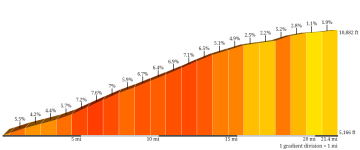

Our 2016 6 4L Hemi with the 4.10-1 in our Ram 2500 4x4 Tradesman Power Wagon when we're heading down on our home's highway 21.4 mile continuous grade (chart below) will down shift to 2nd gear when I tap the brakes more than once on the steep hairpin curves. Always does. Speed limit is 35 MPH along that stretch so holding it back in 2nd gear is fine, but then the speed limit increases on some very long straight-aways to 50 MPH on a grade of around 7% plus (10.1% for a very short stretch). Still holding it back in 2nd gear though no matter how high I rev it with giving it gas. Don't go much above 45 MPH due to the high RPMs. Only when the grade drops to below 6% will it upshift to 3rd. I've researched it and this appears normal for the 66RFE. The truck has an entirely different Mopar 66RFE since October and it's no different from the prior unit. It sure helps prevent a runaway truck. No runaway truck ramps here. So that's probably a good feature of the transmission.

Acccelerating on upgrades it shifts when it should. It's that our grades are quite steep going down and so it's holds back in the lower gears longer.
