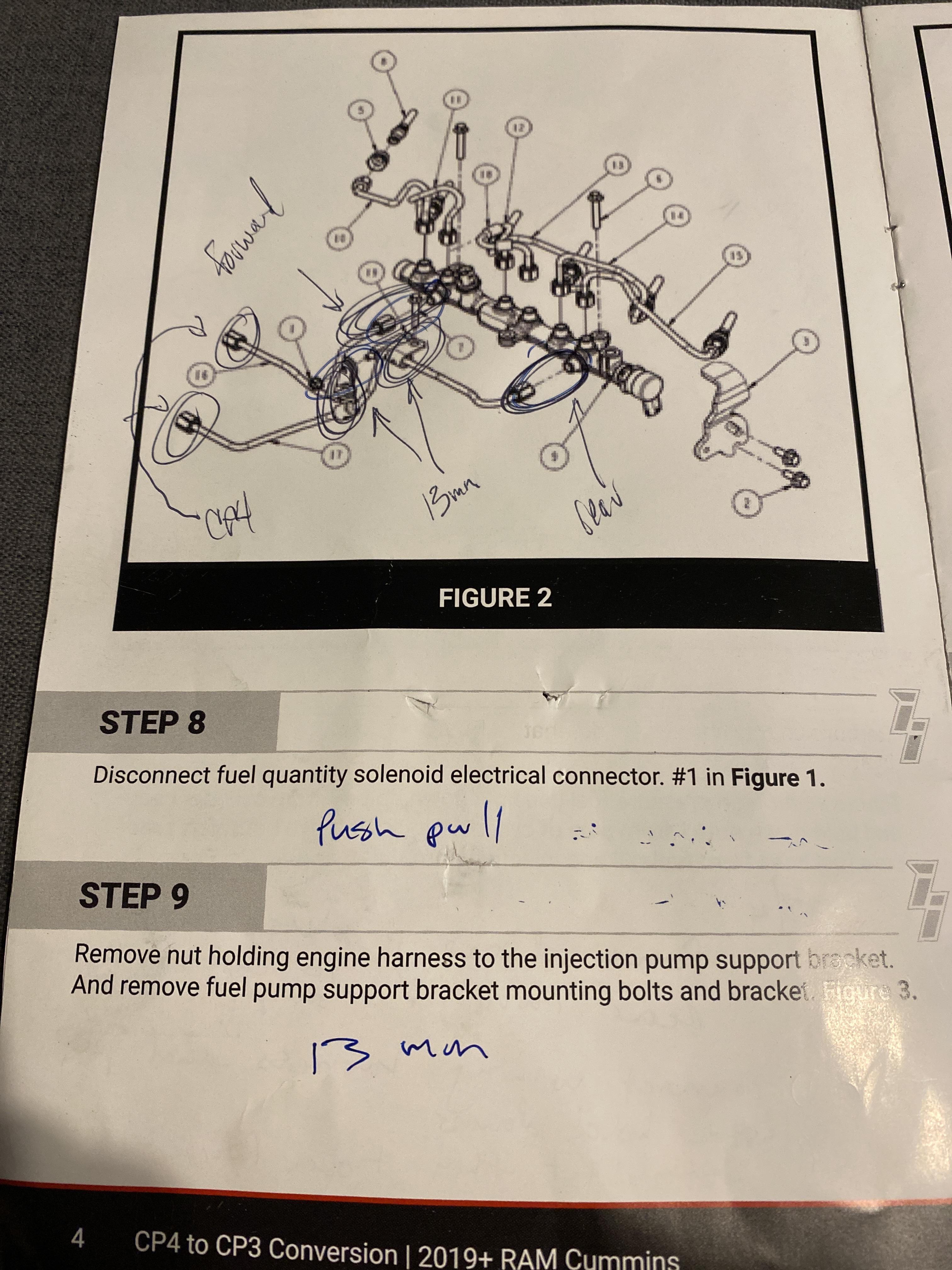

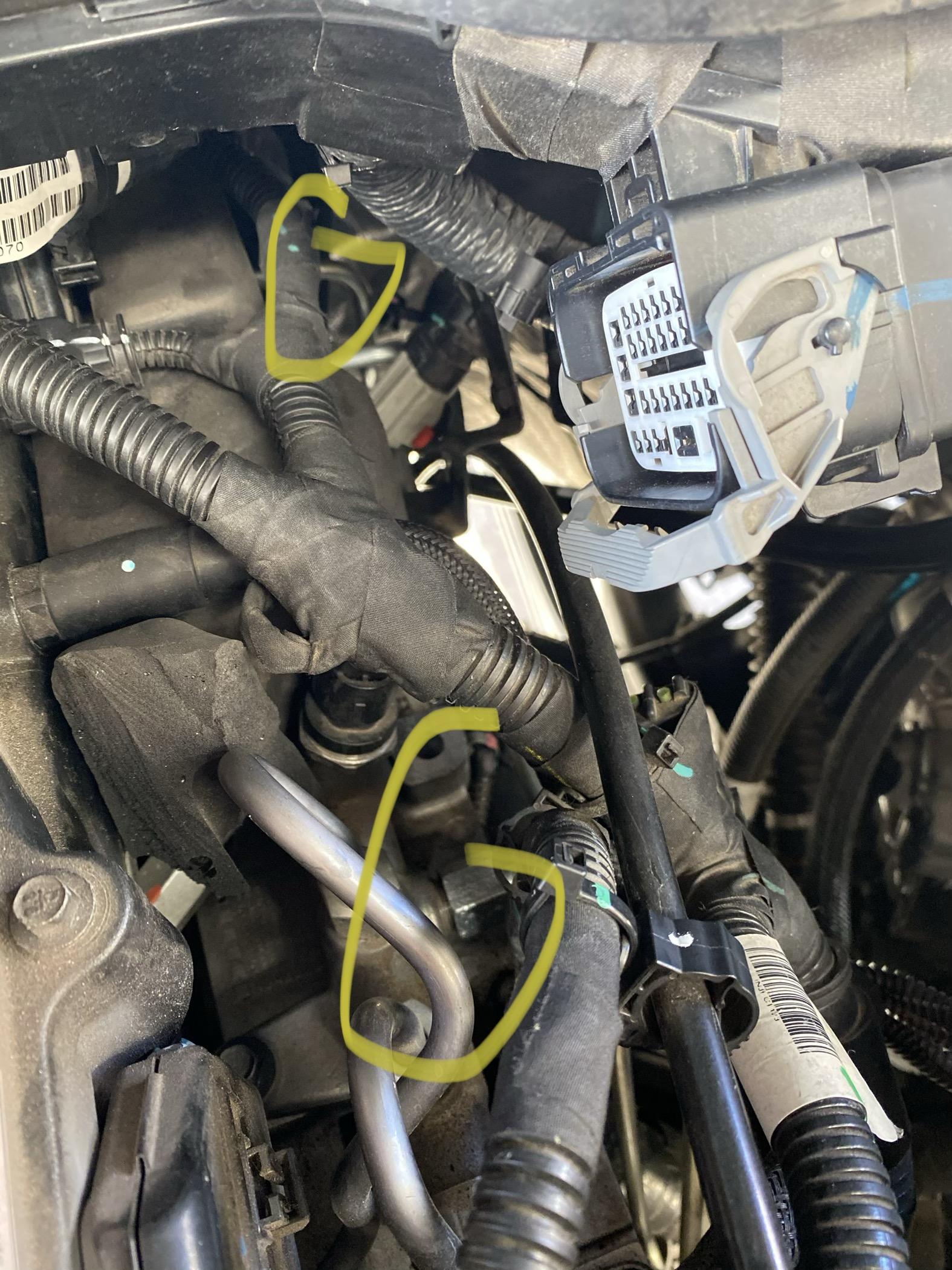

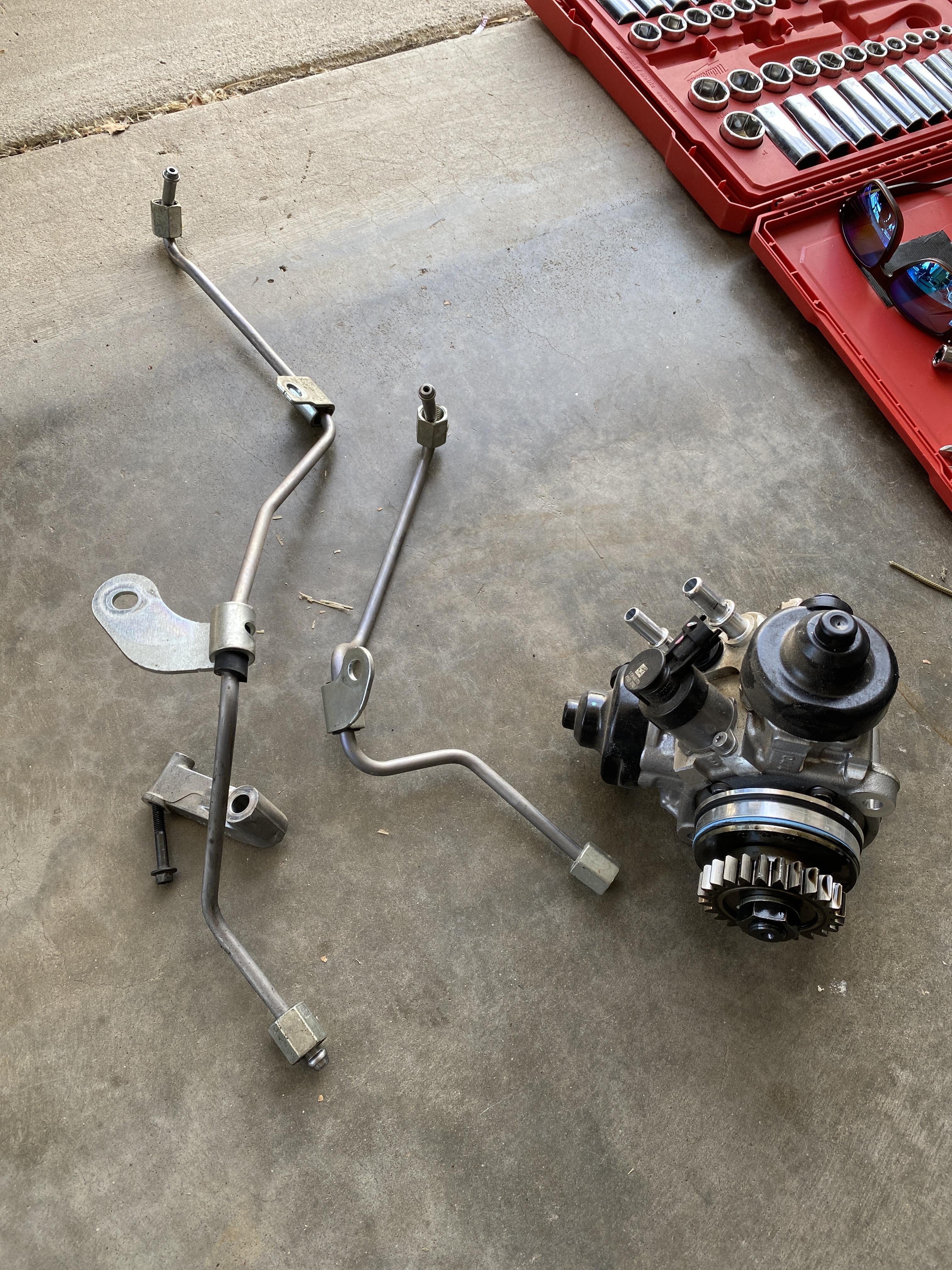

7) as said earlier the HP fuel lines are 3/4 and the connections to secure the lines are if memory services 13mm nuts.
The forward rail is pretty easy to see snd you have a lot of space
The rear rail is a challenge. This is where I would use the open face ratchet head 3/4 with short extension to break it loose.
Use the snips to clip the zip ties that have harp edges
If you haven’t already use this time to undo the harness and move some wiring out of the way. Also disconnect the transmission dip stick (AISIN trucks). You’ll get more room.
Patience is your friend.
