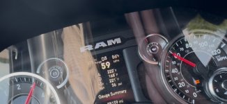

Was Towing with my ‘17 6.4 today and my oil got hot, real hot, twice. I hit 280° on two separate grades, one at 87° ambient and the other at 105°. I was running just over 18K GCW. When the oil hit 280° the rpms were limited to ~4200.
Normal cruising on flat ground, same 18K GCW, coolant is ~204° and oil is ~245°. Highest coolant temp I saw all day was 222° but generally much cooler than that.
I even had a P1521, incorrect engine oil type, active after the first bump of 280° but not the second. It didn’t light the CEL but was active when I scanned. No dash warnings at all.
So I’m thinking the oil cooler isn’t keeping up and it’s time to replace it. How big of a job is it? The oil only has 1500 miles on it, but it’s getting changed after these temps. I’m using PUP 0w-40 and pressure never dropped, even with the temps, and held 53-55 (unlike my 05 Cummins where pressure would fall fast as oil got above 230° with aftermarket pressure and temp gauges).
Anything else I can look at?
I don’t think it’s a sensor. ECT, oil, and trans temp were all 77-81° this morning after sitting overnight.

Also, I’m lighter at a gross combined truck and trailer with tractor on it is a bit more than 16,400 pounds.

I have a 4.5 gen 6.4L so it may not be relevant, but I don’t see oil temperatures that high more like mid 220s.
I've definiatly got more weight and drag with the 10K 5th wheel, but you're temps are more where I'd expect to be.
