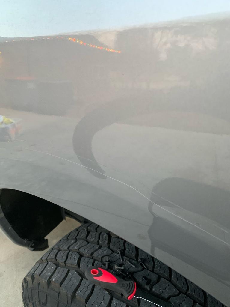

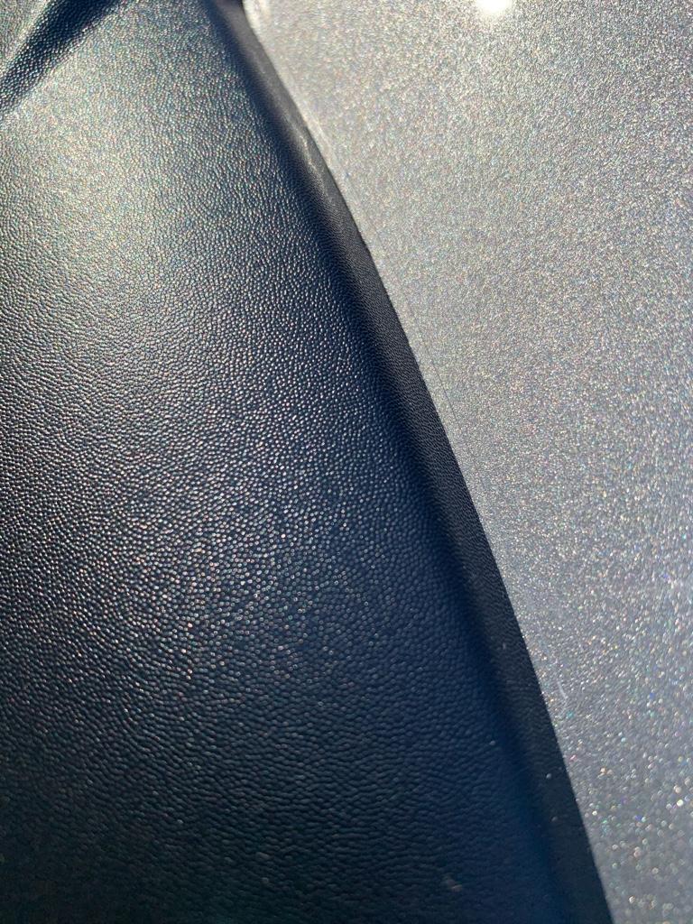

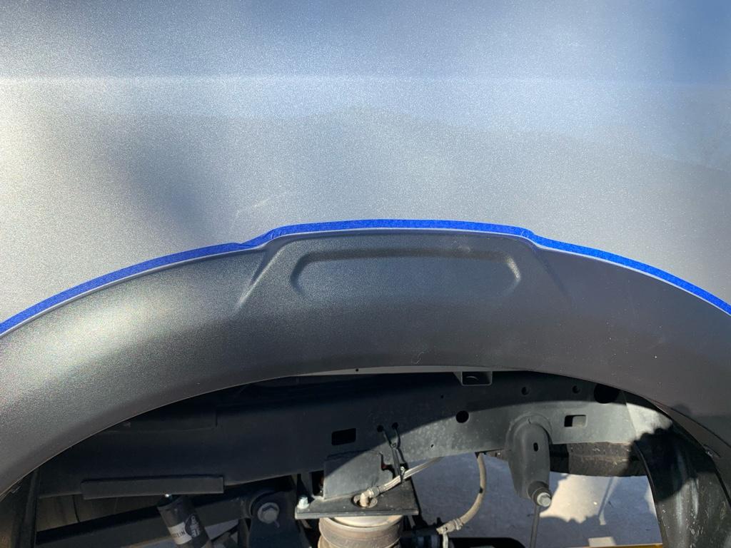

I put clear paint protection under the lips of my flares. Easy to do. Ran the blue tape along the edge of the fenders about 1/16" away. Then used that as a guide to put down the clear protective tape.

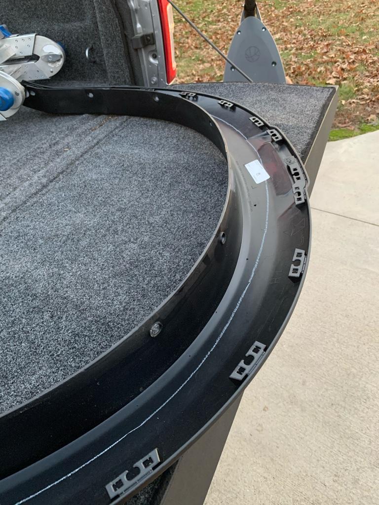

Here's what the power wagon flares look like with the tabs removed. A few have to be cut off.

That's a great idea for the clear tape protection. That was something I was kind of worried about. So from reading threads, it sounds like a person could use the standard Laramie flares or the Power Wagon flares on a Big Horn as long as all the clips are removed? I just ordered the Laramie style flares paint to match my black diamond color. Can the Power Wagon flares be painted to match as well? It's a toss up between the two :/ now that I see them both. I'm not going for big tires, just stock with a +18 offset, so either would probably work well. Where did you purchase the clear coat protecant tape. I would sure like to get some. Thanks for the help...

Did you also use the replacement spats? I'd like to keep them instead of losing them. Also, did you 3M tape the tops down where the clips were previously or do they fit pretty tight?
I got the tape at the link below.
Power wagon flares are textured. Probably wouldn't paint very well.
No it holds tight without any adhesive. I thought I would have to use some but it doesn’t need it and it makes it easier to take them off to clean. A bunch of dirt will get behind them but there’s no different than a factory truck with flares.
I’m thinking about putting wider tape along the bottom lip of the fender. That’s where most damage will be on these and factory flares.
XPEL Extra Wide Door Edge Guard 1/2" x 12' https://www.amazon.com/dp/B00J1WBP2A/

You have to get different spats. They are cheap. The old ones are hard to get off and the clips will break. So make sure you only have to put the new ones on once

What size of tape are you thinking of down lower? I assume the 1/2" was what you used for the upper?
