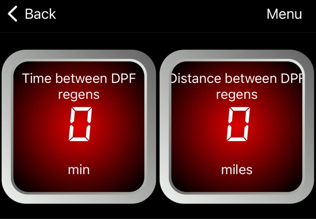

I found that the app OBDLink can see the average distance and time for active regens. When connected it will show the values.
